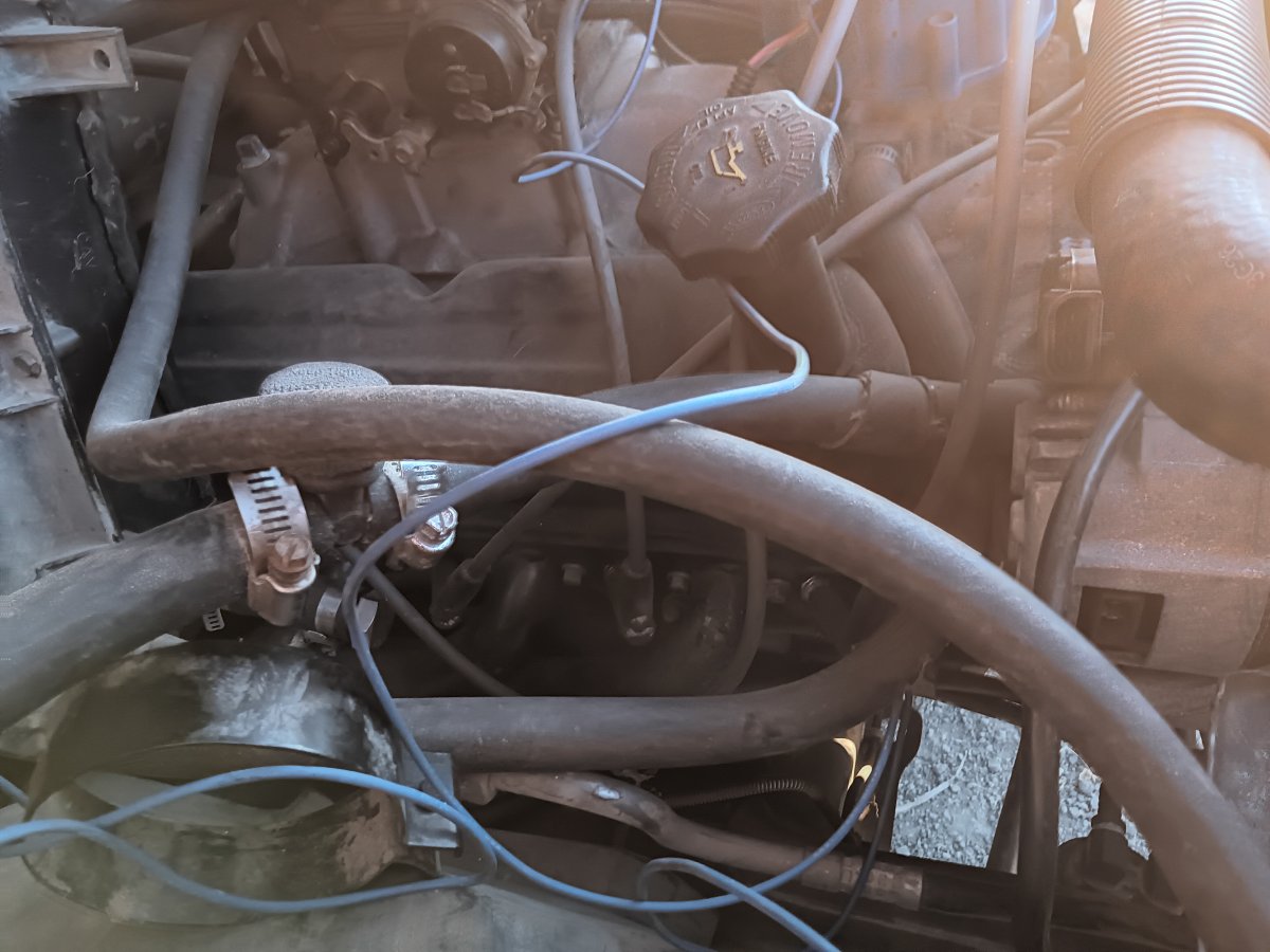

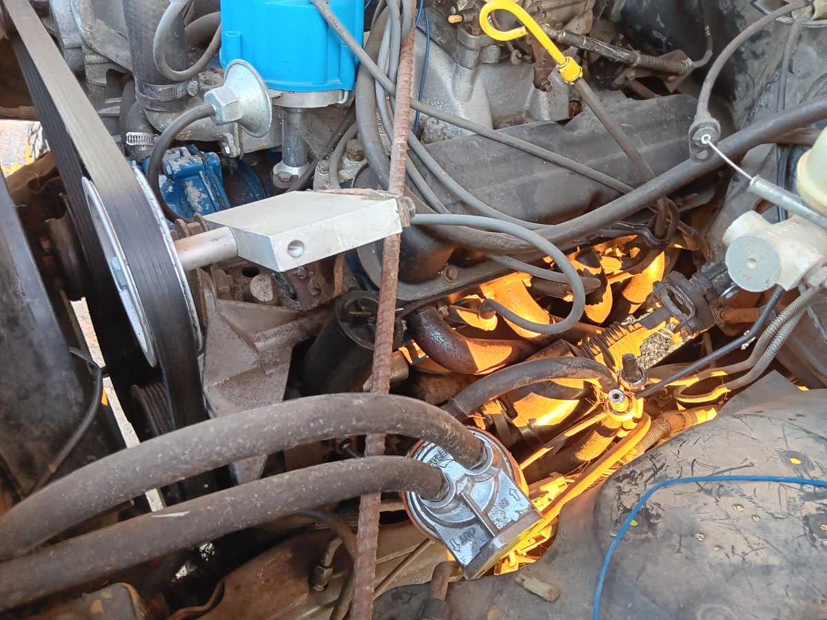

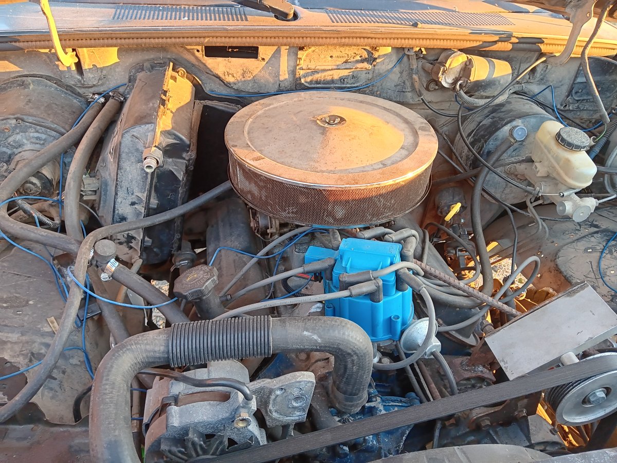

If I remember correctly it was a '92 Ranger, that the harness came out of... Both trucks had 4.0L's from the factory... The 5.0L seems to run pretty good, all of the gaskets are new and the plugs were barely threaded in the holes and the wires were all on the wrong spots, no where near the 5.0L or the older 302 firing order, I'm pretty sure I'm the first one to hear it run since it was rebuilt... I'll take a few pictures of it this afternoon and post them... I'm not 100% sure on the brand of distributor... They didn't put a msd box or anything like that in there...
I know it won't take much to make it run but I'd like to make the power windows and locks work along with the heater, wipers, guages, headlights and tail lights... I'm gonna try and make it a daily for my ol'lady...
Looks like it has a aftermarket 1 wire HEI distributor on it. A hybrid of GM style on top, and the bottom machined to fit the Ford. They work well.
