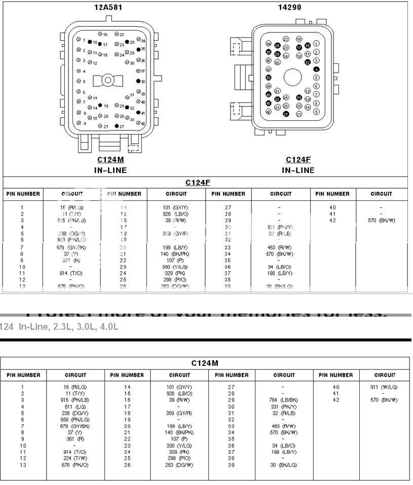

who said im using that wiring?? and what makes a rig EEC-V or EEC-IV? im gonna guess the computer. im not using the EEC-V computer.

EEC-IV is the best Ford EEC to choose for swaps, EEC-V is only a good swap if youíre going to use all its vehicle control functions
does anyone have a wiring diagram on what wire does what. the only thing i can find is a color code

As for doing the swap, it's the exact reverse of a 4.0 swap really. Check out 4.0 swap threads (there's a few on here) and reverse engineer it.

Dash wiring will be the biggest obstacle. Normally you could just swap the dash, but the break line for dash swaps being nice was 92/93 MY. Worse yet, the Rangers got OBDII systems in 95, so that will be even more fun as the dash harness is different.
temp,oil pres,amp gauge and tach work,just need to hook up the speed sensor for the speeedO
