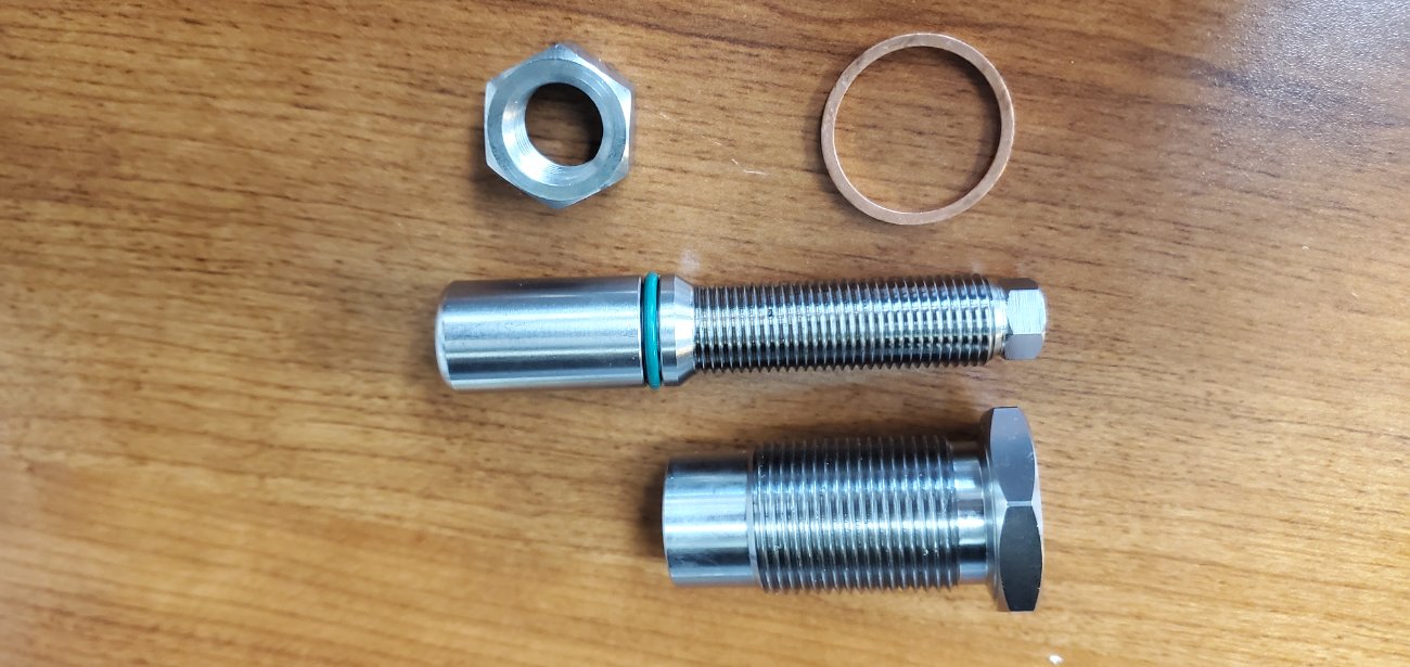

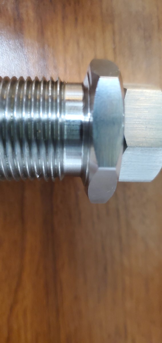

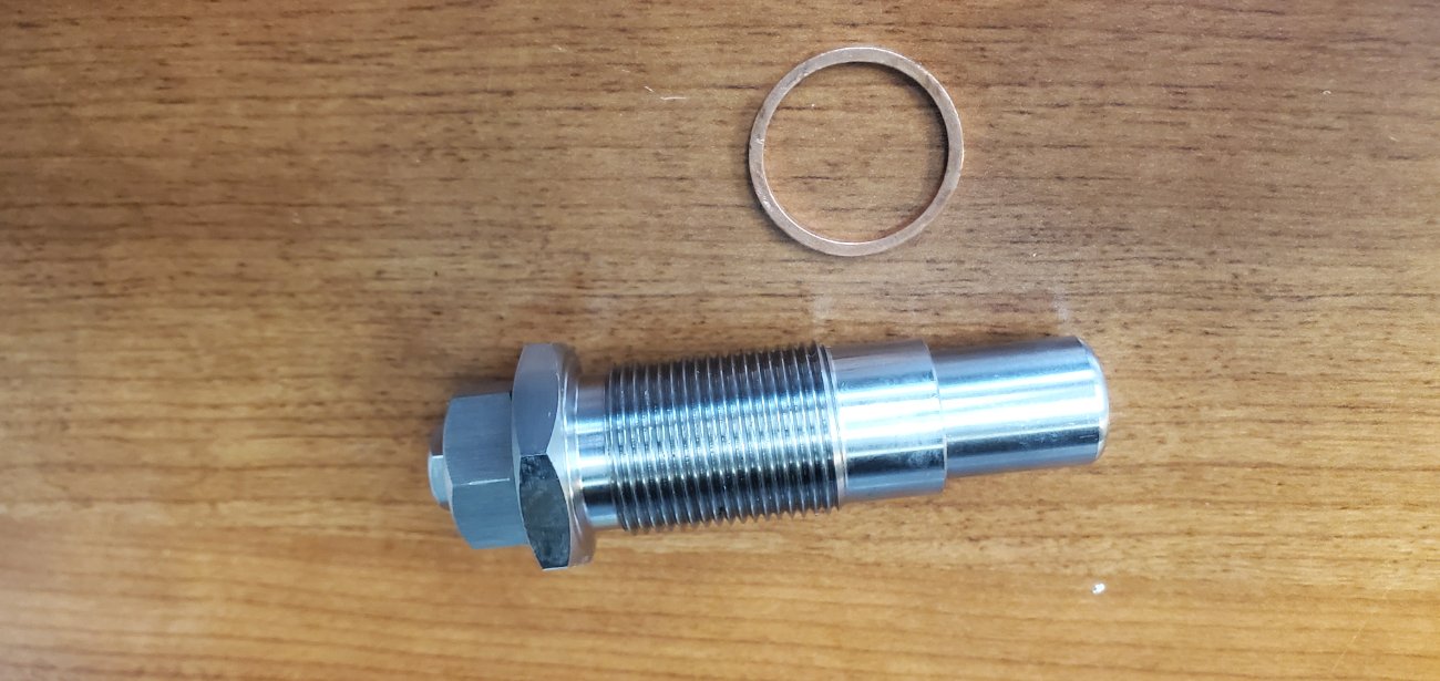

Well. They're interesting little buggers. Machining is "China good," meaning some chips and residue on the slightly imperfect threads. Not aerospace quality, but will probably work for automotive application with some cleaning.
Quite heavy as I opted for the stainless ones. Not sure as to what the o ring is made of and if it will hold up to years of abuse in an engine.

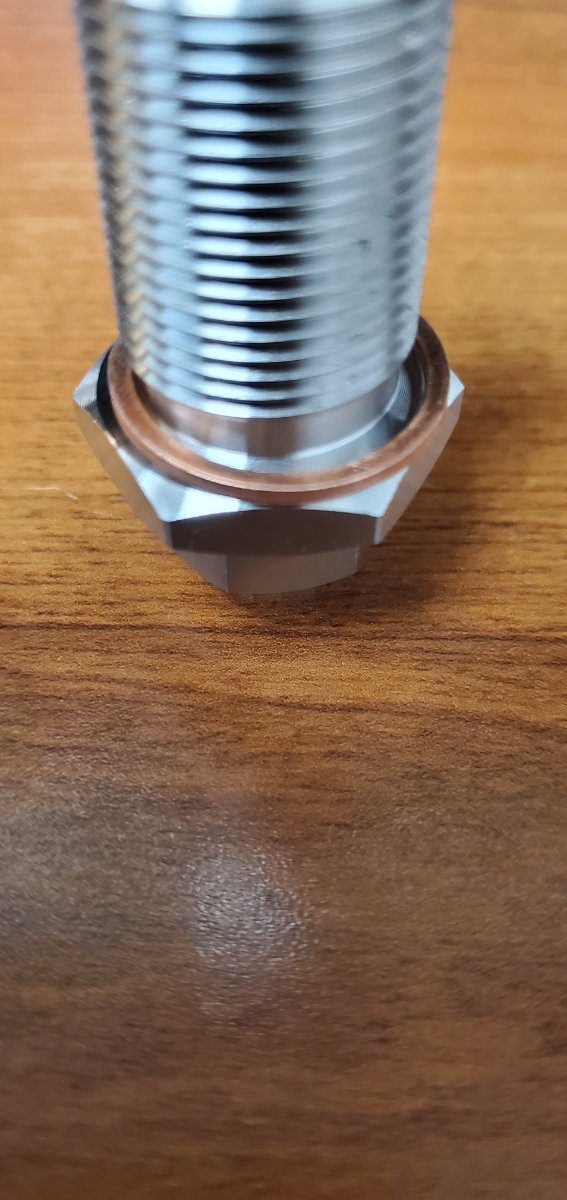

Only complaint is the sloppy fit at the top bevel with regard to the copper gasket. Not great, as pictured. Still, probably usable.
Going to hang on to these ones with a printed copy of the install and adjustment procedure. They look like they would work, in theory. There is an extended version as well. May look at a set of those.
