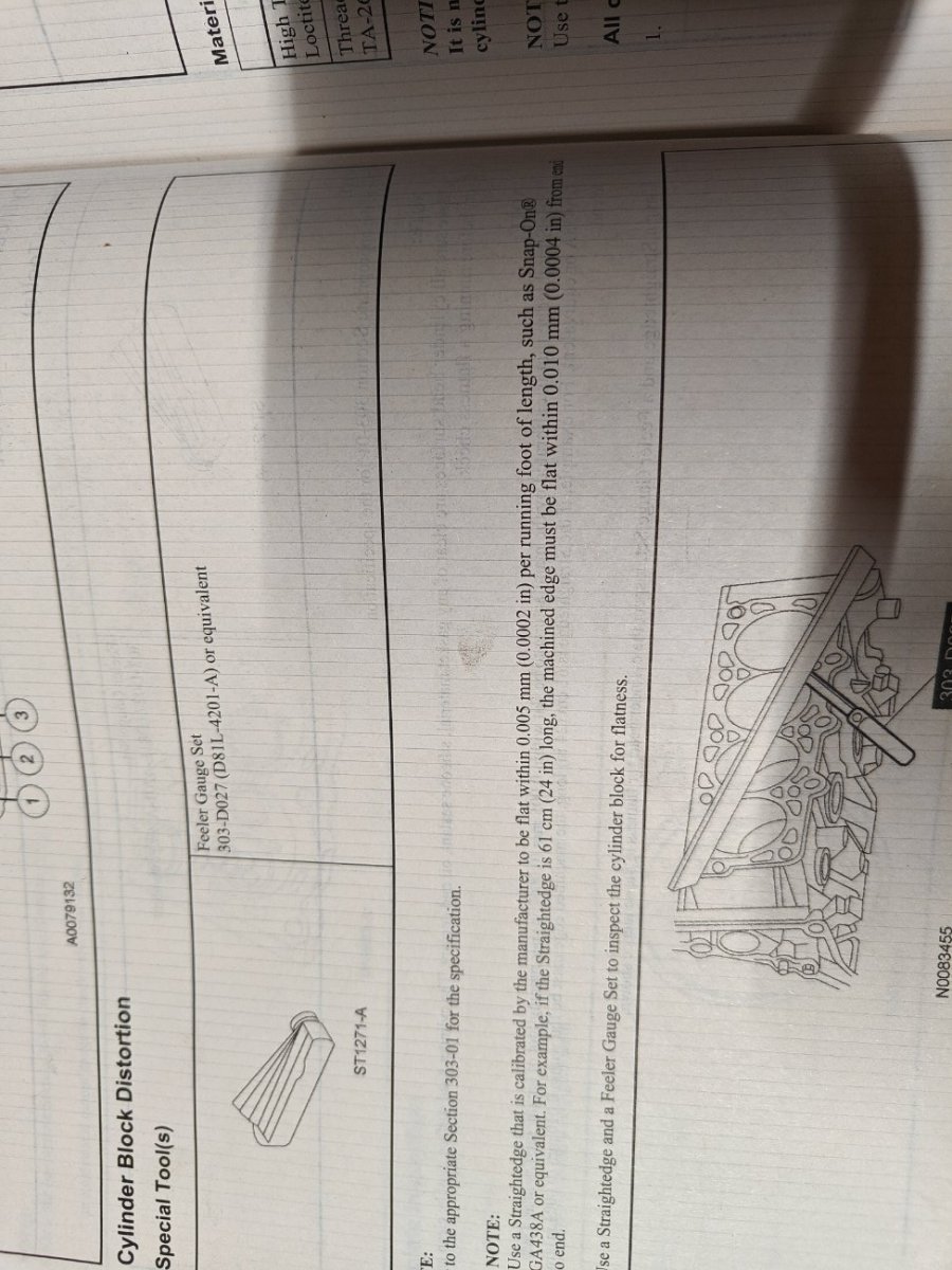

This has got to be a typo right? The manual says the block and heads need to be flat within .0004". I'm thinking they meant to write .004"? I hope, if not I'm screwed haha
This has got to be a typo right? The manual says the block and heads need to be flat within .0004". I'm thinking they meant to write .004"? I hope, if not I'm screwed hahaView attachment 135988
Go with the metric measurement, and cross reference. My bet is on .004....
Turns out it is .0004"
*** EDIT ***
The measurement of .0004 is for the straight edge, not the block or heads!
You could put a straight edge up against a piece of glass to check the straightness with feeler gauges.
*** EDIT ***
Yeah, a "straightedge" for checking heads is kind of special.
Don't be using your wooden ruler from 3rd grade.

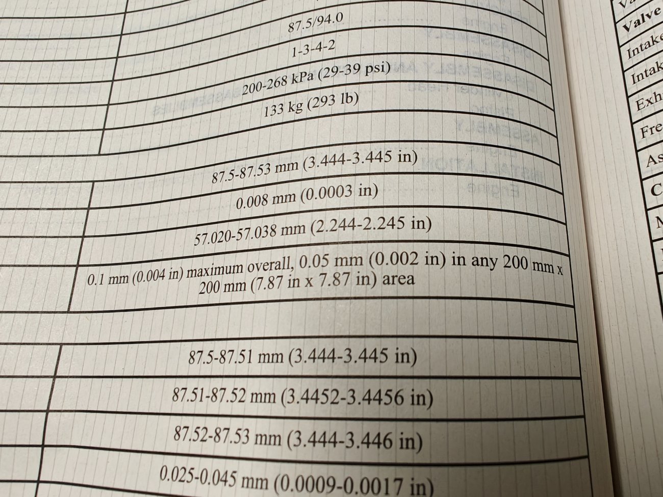

I do have a machinist straight edge. I got it off Amazon but it's allegedly certified straight to within a couple thou. There's just one spot that worries me on my block and I can fit a .002" feeler gauge in, that's right above cylinder 4, the cylinder that leaked the most before.
At this point I've gone this far so may as well send it but it still worries me.
If that spec is for the straight edge, then what is the tolerance for the block deck does anyone know? I've done some reading and some say it's .003-.005"?
You were right, that spec was for the straight edge. The spec is .004" for the block
