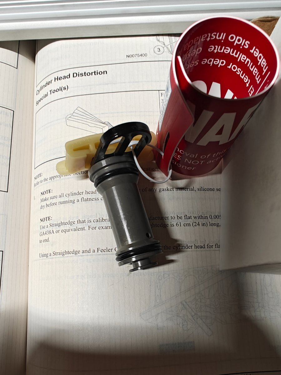

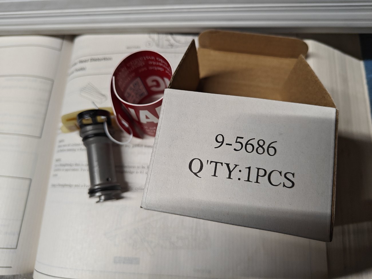

Check out my sweet timing chain tensioner that Rock Auto sent me. Cloyes part # 9-5686 if anyone wants it let me know. Not sure what it goes to but not my engine! It was only $17 on "dealer closeout" at Rock Auto so not even worth my time to return.

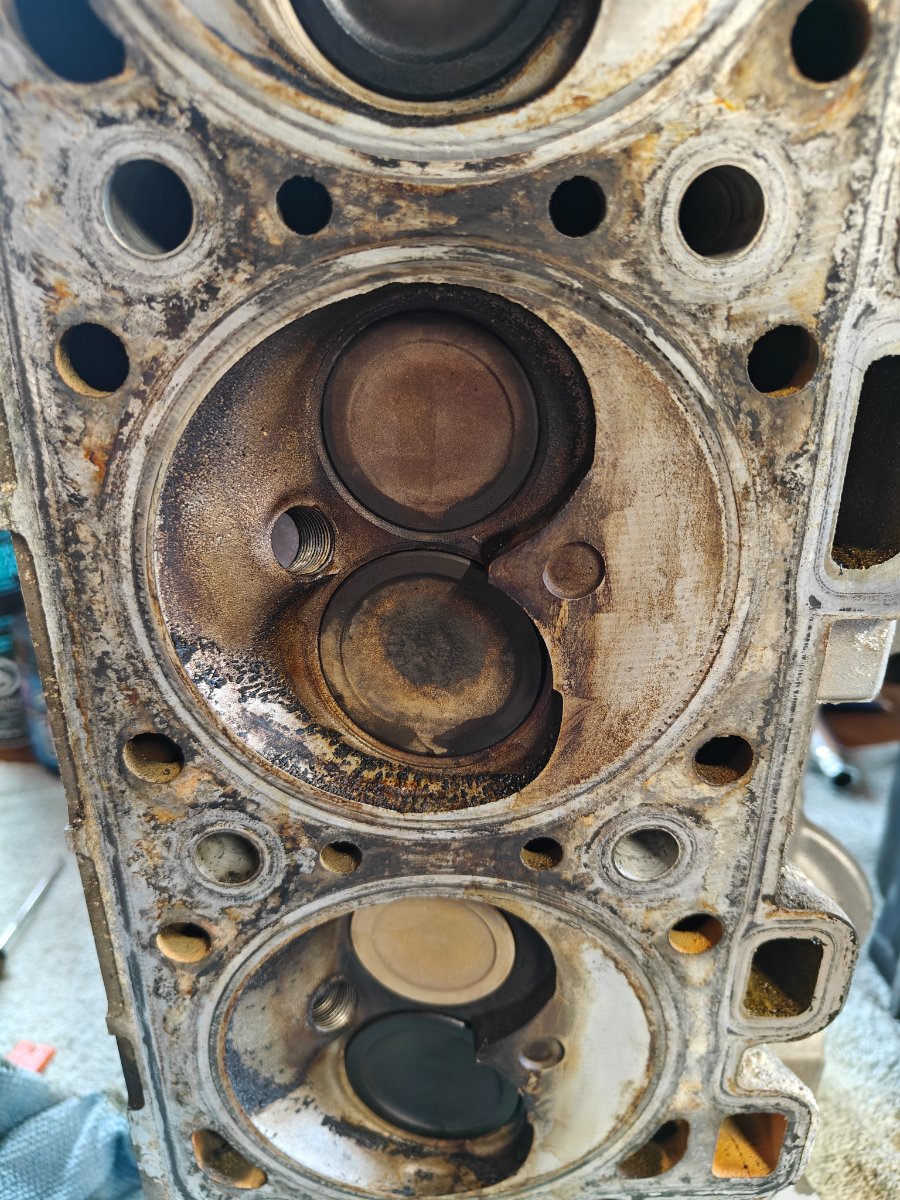

one question. did you examine the head gaskets thoroughly to check for a fault in them? how did they turn out? could you see a tear or a blown part? reason asking, is that the piston and valve pics you posted make it look like pretty normal wear in them. i don't see a steamed cleaned piston top from a blown head gasket releasing coolant into a hot chamber.
It wasn't releasing coolant into a hot chamber I don't think. My problem was confirmed with a bore scope. When the truck sat overnight and cooled down, coolant was leaking into a few of the cylinders causing misfire on start up. It started last summer and I chased my tail thinking it was a fuel pump issue. Then I discovered the coolant in the cylinders. Right before I took the engine out it seemed to be getting worse and worse every few days so decided to get it done. The Ford dealership also confirmed I needed head gaskets though they quoted me $6k and that's IF the block and heads were flat.
There is evidence on the head gaskets and block where they were leaking between cylinders but I couldn't really see where the coolant was getting in, maybe same place?b Also 4 of the six pistons cleaned up easily with a quick wipe of a rag and brake cleaner, only 2 pistons I had to use berrymans and a toothbrush and scrub the carbon off.

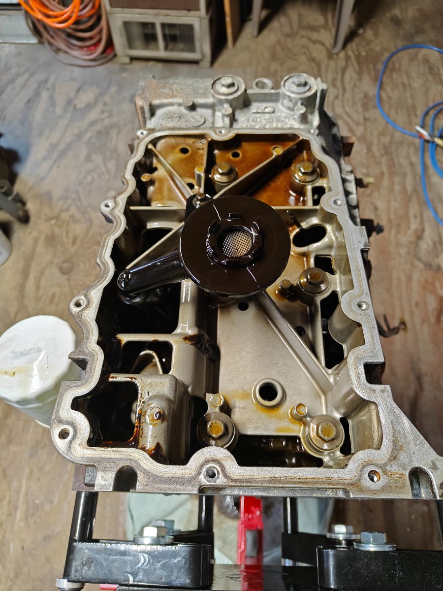

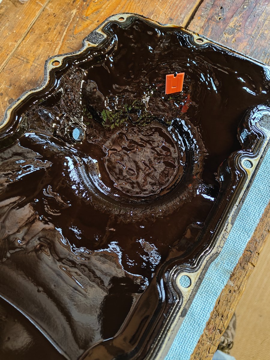

Yikes, I'm glad my lower oil pan gasket was leaking so I decided to change it. Oil pan had over 1/2" of sludge in the bottom.
