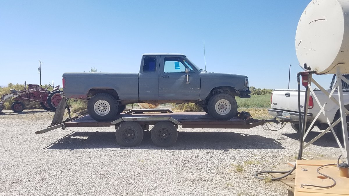

4.0 retrofitted with a distributor?
So I picked up an 89 today. They guy had started a 4.0 swap. He took an engine out of a automatic 92 explorer and swapped the engine, harnes and computer over. I don't know if I should pull the 4.0 harness and put the 2.9 harness back in to try getting it to run with the distributor or just go through everything and double check his work to finish it up.
