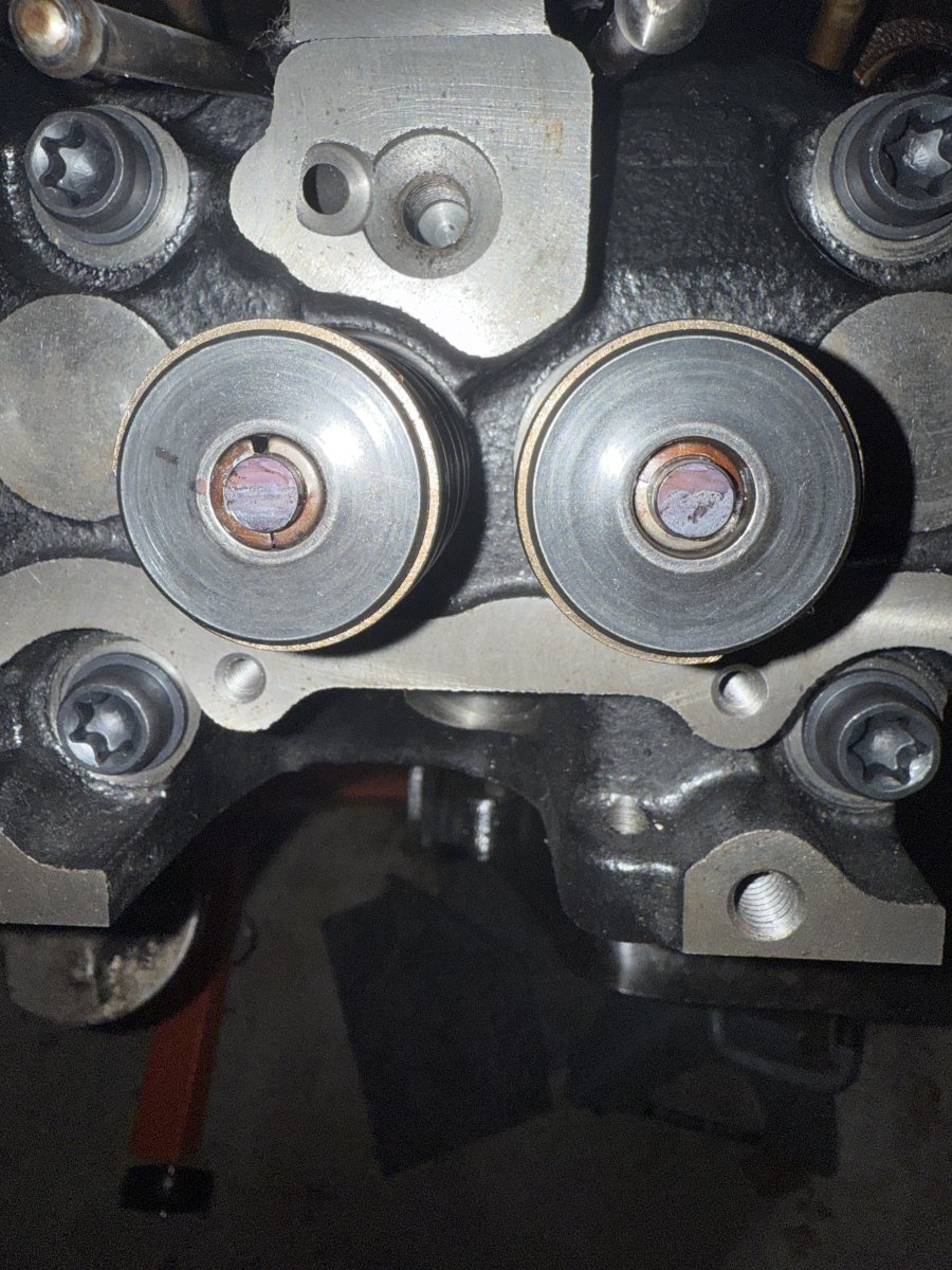

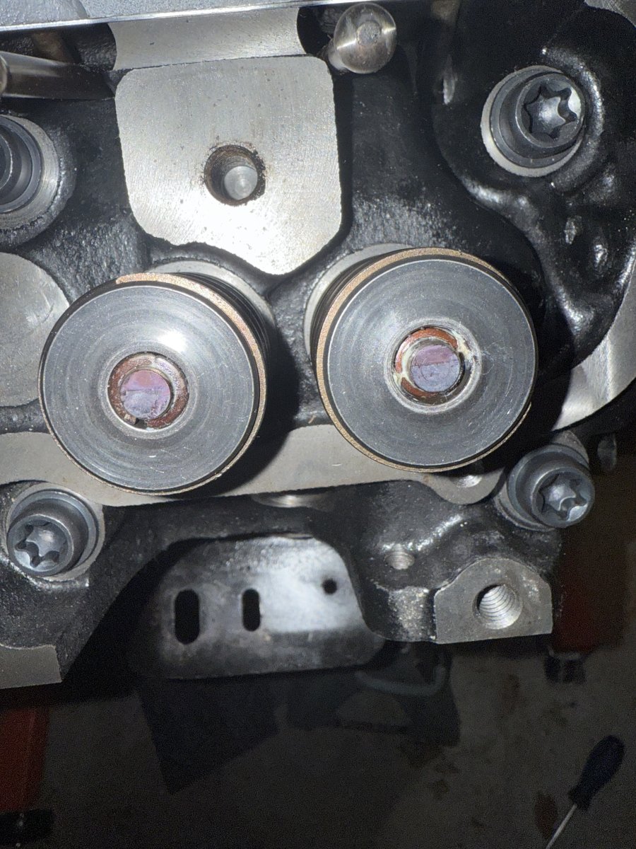

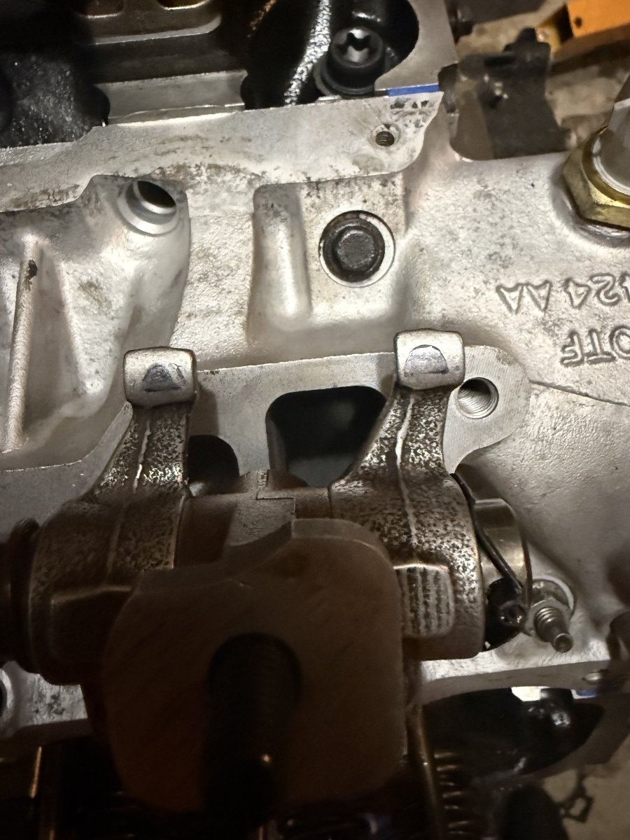

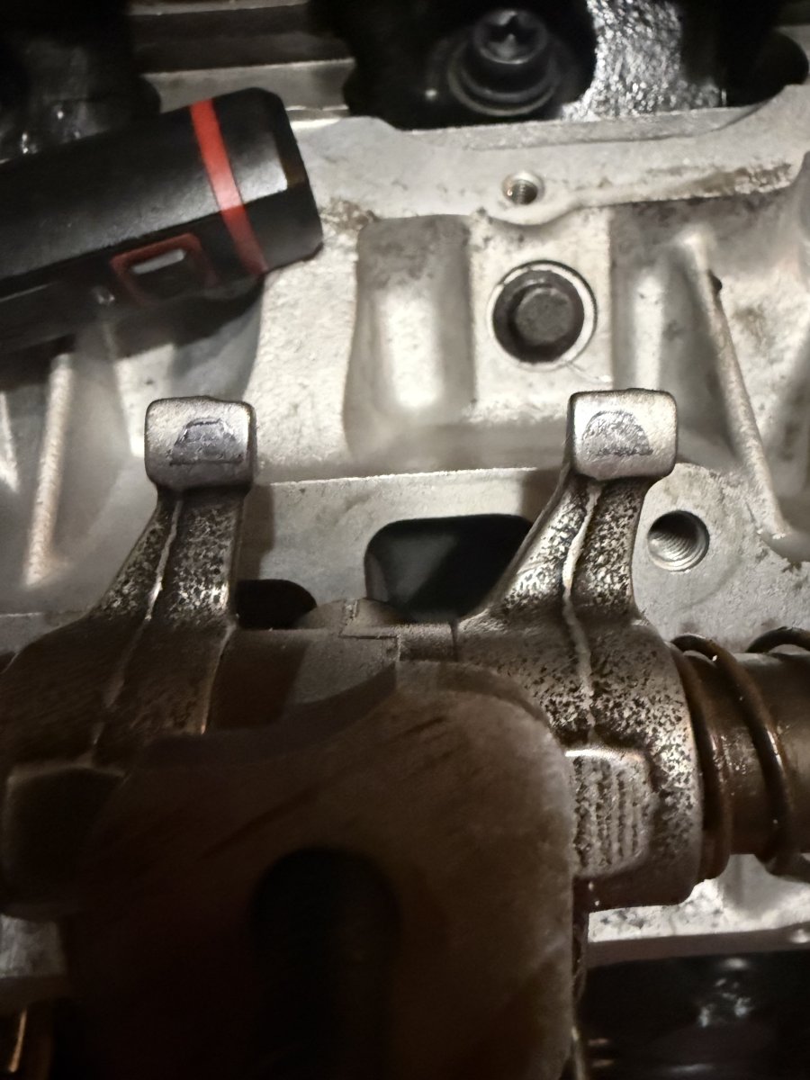

Hello all, I am in the process of rebuilding my 4.0 OHV and I’m at the point where I need to figure out pushrod length. I put in the Delta Cams 410 cam regrind so I was assuming I’ll need bigger pushrods. I checked pushrod length with my old stock pushrods to see if I would actually need to change anything and got the results shown in the attached pictures. From the pictures it appears the rocker is sliding all the way down the valve. Would this mean I need smaller pushrods? It is also worth noting that I had my rocker tips cleaned up by Delta cams but they told me that wouldn’t change the geometry. Any input helps thank you.
Is that some kind of marking compound or wear on the rockers and valve stems?
It looks so much like the wear pattern my original parts had that it's hard to tell.
Yeah I was thinking the same for the rockers. I’m just worried about the valves. When doing the sharpie test with roller rockers the wear mark should be in the middle of the valve. Since these are flat rockers I’m not sure if the wear mark going completely down the valve is bad or normal.

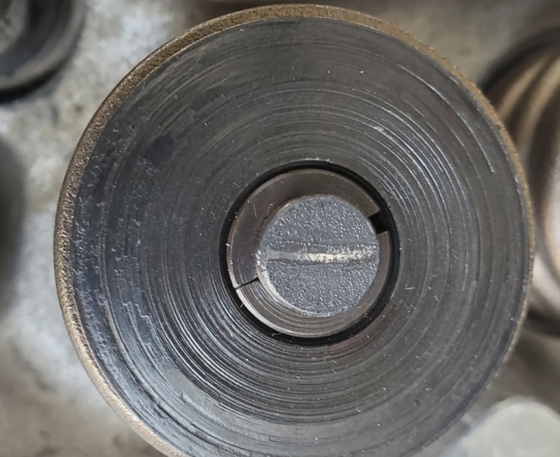

When checking pushrod sizes I was under the impression the wear mark on the valve should look like the one in this attached photo. I guess my question is, is it normal that my wear mark looks like it does?
Assuming you have correct geometry already, what would you do to change that? A sharper curve on the end of the rocker arm?
Well that’s why I’m a little worried about with having the rocker arm tips reground. I’m worried they may be too flat.
@Maxsaaty
I do not see an issue with the way your rockers are contacting your valve stems. Additionally, the crew at Delta have been a big force supporting Rangers, BroncoII's and Explorer's in the PNW for decades.
Ok that’s honestly what I needed to hear. Thank you.
