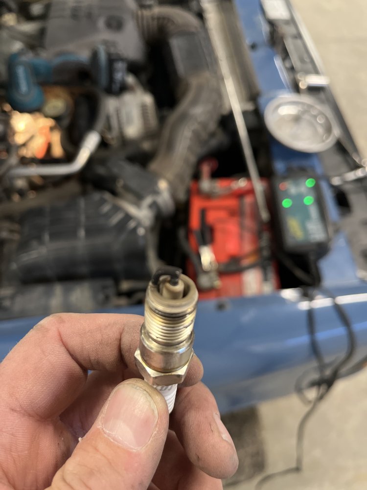

The plugs all looked pretty lean. #1 looked the best

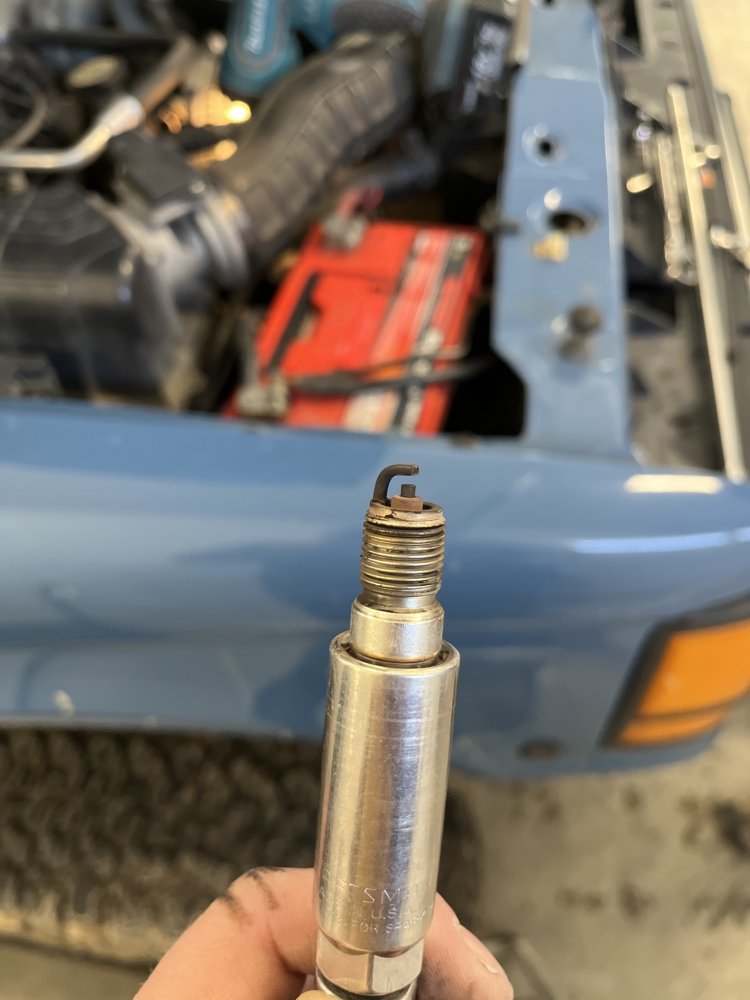

#3 looked like the rest
