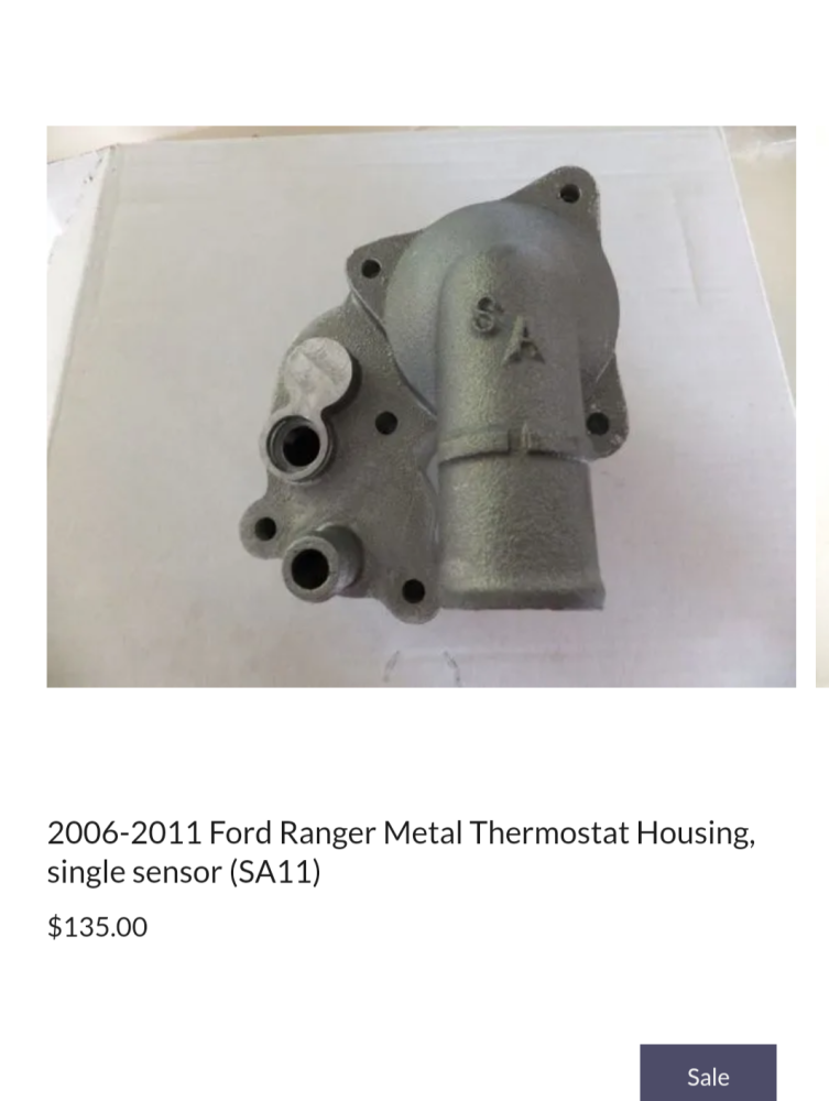

The problem with plastic thermostat housings is they will last for a while, but the heat cycling gets to them and the lower housing cracks. Then you have a sudden catastrophic loss of coolant with little warning. It's not just Ford Rangers, but certain Chrysler products and other Fords as well.
Get the aluminum Simmons Auto Sportz housing so you can sleep better at night. I used a new Motorcraft thermostat and temperature sensor with it.

Thank You! I didn't know Simmons had an aluminum option and will certainly look into that.

Glad you found the Simmons housing. They ain't cheap, but they're good.

Defintely recommend swapping the JunkPlastic TStatHousing to an Aluminum Housing.
Basicly 2 versions of Aluminum Housing available: one from SimmonsAutoSportz & all the others.
Either Aluminum version has slight advantage\disadvantage to the other;
either Aluminum version is much better than the JunkPlastic FactoryOE\AfterMarket versions sold at your local parts store.
Click here for more on Aluminum TStatHousings for the V6~4.0L~SOHC.

Thanks for the tips...ordered the Simmons Aluminum last night! This is the 3rd time and hopefully the last time I have done the housing. smh...
