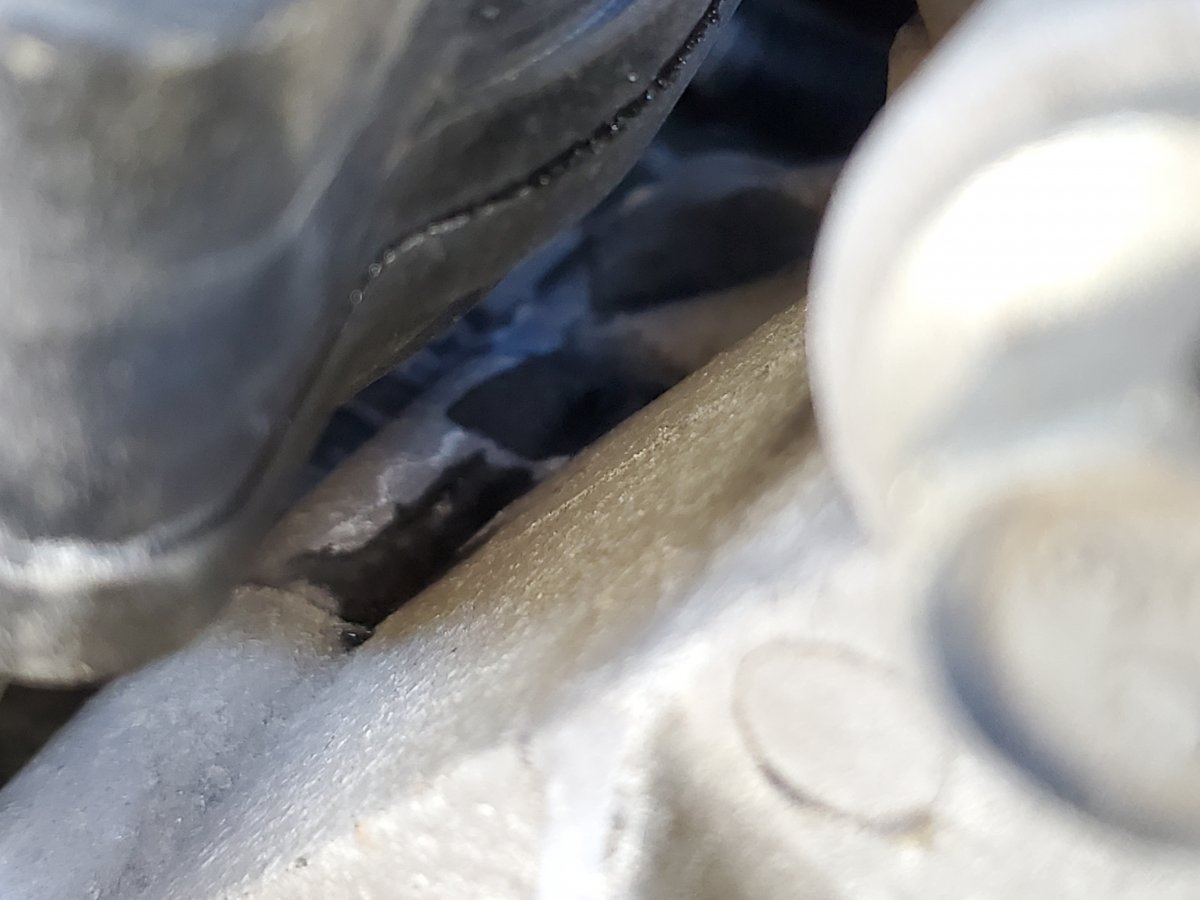

I have a bit of an update, earlier today I found moisture on the housing, as well as small amount of pooling atop the power steering pump bracket.
Having shoved my phone under the throttle body, I was able to get this image...
Notice the moisture along the plastic welded seam, and on the aluminum mount.
Good that now you've confirmed problem & now know that you need a new TStatHousing.

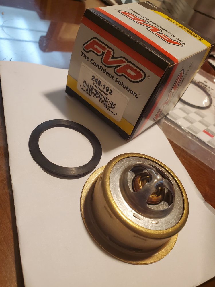

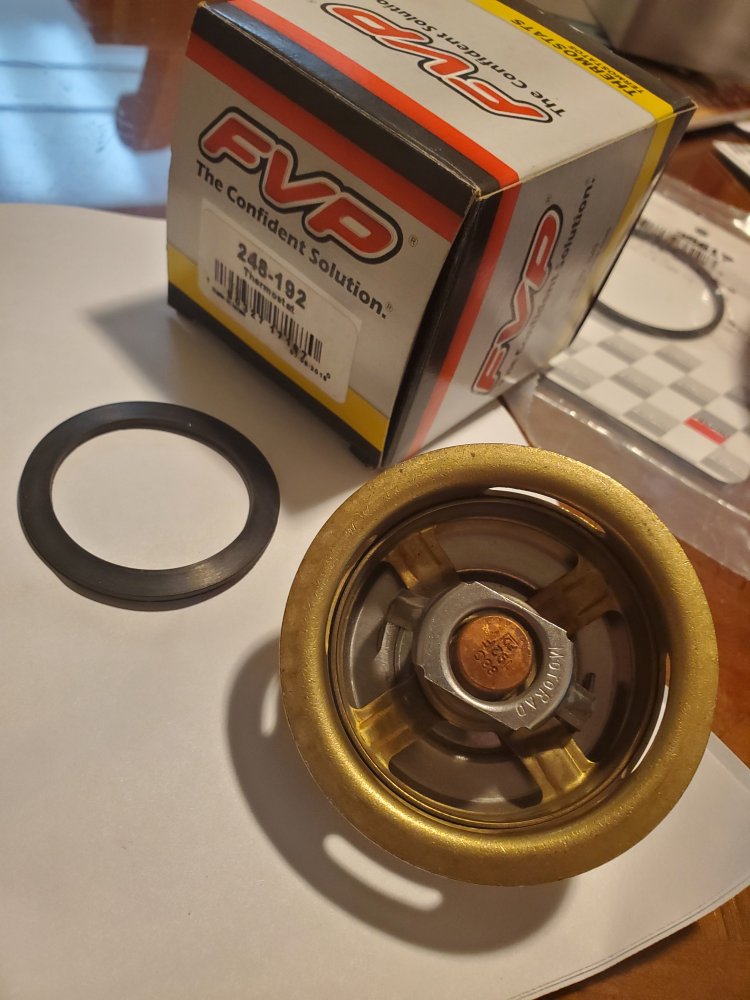

First half of the parts arrived today, but the thermostat is kinda funky looking... Know if this is correct for the 2007 4.0L? The thermostat doesn't match the pictures online for the part number. Not really wanting to tear into the engine without all the parts present in order to find out
I thought as much.... I got the private label off rockauto. Best as I can tell, the wrong part was in the box. I'll see about getting it swapped out
That doesn’t look like any thermostat I’ve ever changed.
