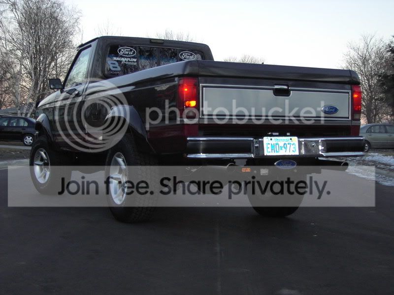

i have a custom setup on my ranger and i love it. i have the dual cat setup (91) i cut one off and had a chambered box muffler welded to it with a dual outlet with 2-1/2 duals back. muffler is V-force (cheapy) but sounds nice... then i added headers and gave it a nice tone. i would use stainless tips though. its worth the money they last a lot longer. i bought magnaflow stainless rolled edge 12 inch tips... just remember the longer the tip the heavier they are which can mean breaking hangers.
here's a video of my truck you can get some sound out of it to hear...
picture of my setup. receiver is gone now and the pipes are evened out lol
