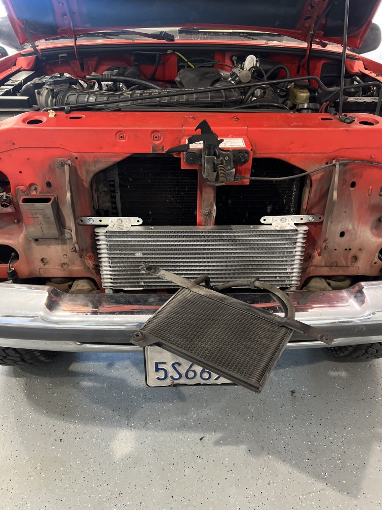

4.0 crap mileage
coolers already in. One thing I do know is to keep these a4ld's cool to make them live. We've desert races a few rangers.
min thinking a new radiator is going to be the fix. I hope.
