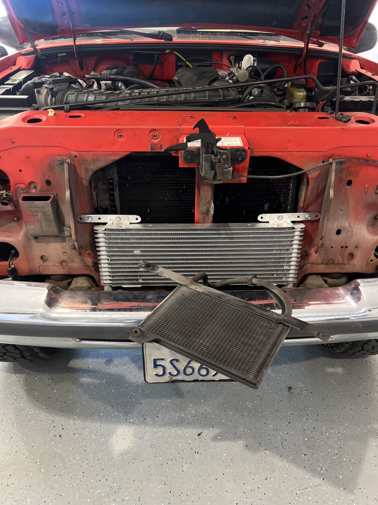

Also installed a aftermarket trans cooler over the weekend. I'm thinking about bypassing the radiator since the water temp is keeping trans temp close to 200 still.

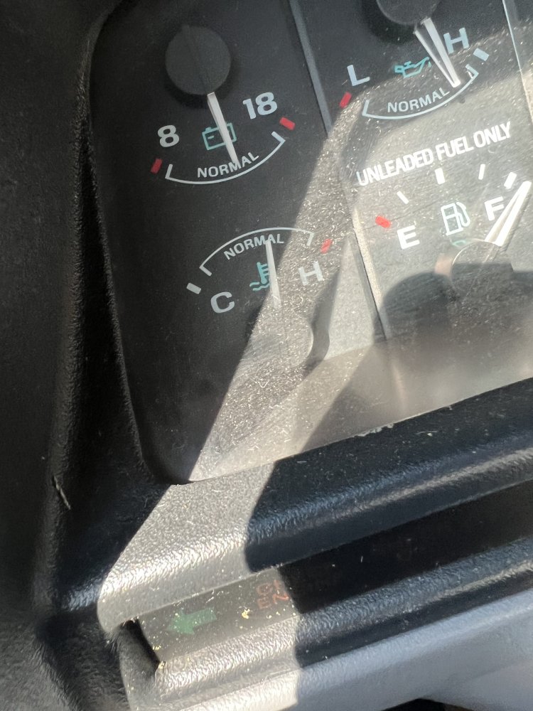

also want to replace the radiator. What's a good replacement? With air temps over 100° this things running hotter than I'd like even with the ac off. Between the M and A on the gauge. And that's driving easyyyyywith ac off.

Any recommendations on bypassing the radiator trans cooler and what radiator to get?

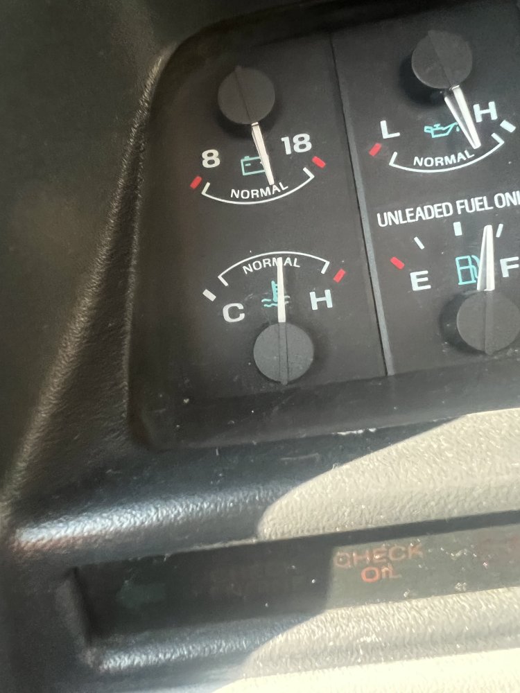

This was today driving up a half mile hill with the AC on in 100° heat. Never really came back down till I turned the ac off
I think the Explorers or Explorer Sports had that engine and a double row core. That might be something to check out.
As far as the transmission cooler, you could install and auxiliary cooler in the system but you’ll want to check on what the right size cooler would be.
I would do a step at a time though. The double row radiator might be enough to get you where you want instead of shotgunning it.

coolers already in. One thing I do know is to keep these a4ld's cool to make them live. We've desert races a few rangers.
min thinking a new radiator is going to be the fix. I hope.
