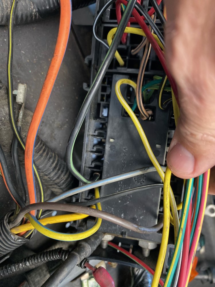

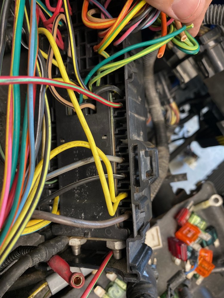

Looking for some help and detailed info on the distribution box wiring. I was given some info to swap all the B2 stuff to the 4.0 distribution box. I'm using the B2 Power harness that plugs in the drivers side and the 4.0 ECM harness that goes through the passenger side firewall.
B2 is an 89
Explorer is a 94
Does any one have pics of the underside their distribution box that shows what wire goes where? or detailed drawing a 5 year old can understand that would be appreciated.
I also don't understand how how the diode is wired.
I was also told there needs to be a wire run or spliced for the alternator. Any details on that?

Yes, I have seen them. I'm specifically look for the distribution box wiring.
I haven't seen anything on here about that.
I'm not understanding the alternator splice either.
