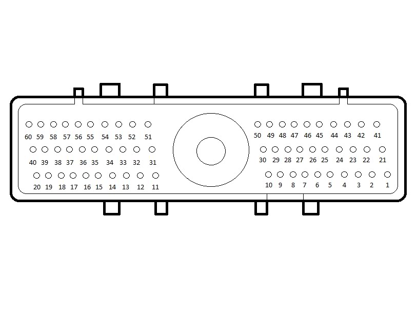

There is a great turbo swap section in this forum's tech articles page. It has everything you need (Re-pin spreadsheet, ranger and TC wiring diagrams) except what I attached here. I found this useful in keeping track of things and will try to get it added to the tech library.
