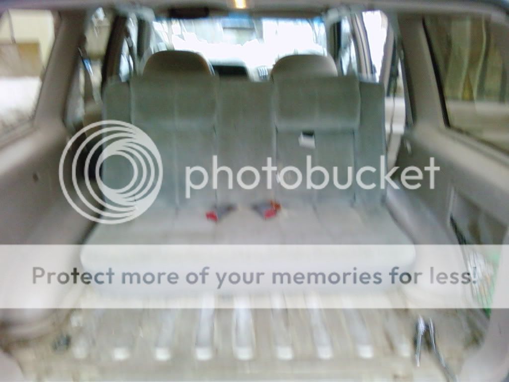

test fit a seat tonight. Not the seat with the built in car seats, its one without. I'm using this for mocking everything up. This is a pic i took of my kids with there arms stretched out. My oldests hands are about 3 or 4in from the roof, my sons hands are around 7 or 8in. She's 6, so I figure this should be fairly safe.
I've decided to mount the seat facing backwards. I could not find any issues with this. RV's are backwards, some of the newer minivans are, ect. By mounting the seat backwards, it puts the kids heads about 3feet from the back for the explorer. Compared to the foot that is in the mini van.
I removed the base mounting brackets from the minivan seat, am planning to bolt this right to the floor with no gap. Any issues with this? Setup this way the new seat sits at the exact same height as the seat with the carseats on it. Will post more tomorrow, better pics to i think...

Finished. The whole thing took a few hours to do. Wasted to complicated....basically I used the mounting plates off of a 5th wheel, drilled holes to match the mounting points of the stock brackets and bolted the seat right to the floor. I used angle underneath, there are 3 bolts in the front and 2 in the back. The seat has built in harness's for car seats and since I'll NEVER put an adult back there due to no room, and this is only a temporary measure until I gather enough parts for my truck ( extended crew cab...should hold 8 Adults safely when done ) I never bothered with mounting other seat belts. If I ever decided to I'll either mount lap belts to the steel plate, or modify the pillars in the explorer to hold 2 shoulder belts in the back.
I'm very happy with this so far, the only other thing i want to do is find a cover for these seats so they match my interior. Here are pics of it, I have yet to take a pic of it installed with the carpet in,etc. I'll take that tomorrow or the next day.

Seat with built in car seats test fitted

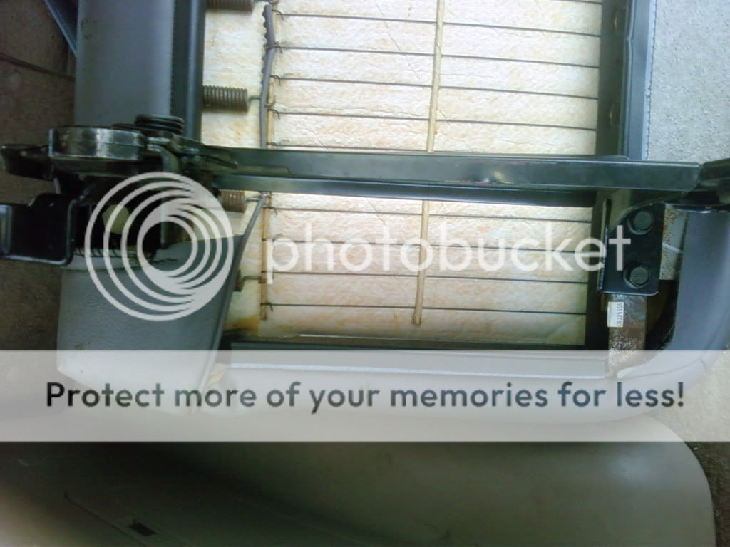

Original brackets on dodge caravan bench seat

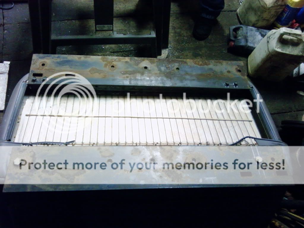

First plate mounted
Both plates mounted
Sorry these pics are so big, i couldn't get the thumbnail link like the last ones for some reason. I still have to post the final installed pic. There were a few differences between this seat and the first one i test fitted, both are the center 2 seater seats from dodge caravans, the first was from a 95 caravan ( w/o built in carseats ), the 2nd was from a 93 dodge grand caravan...to the best of my knowledge the grand caravans are the only ones that came with built in car seats.
The main difference I ran into was the positioning of the kids, the kids sit about 4inches back into the seat ( just an approximation ). So they're more or less in the same spot as the same area as the stock seating. Also I measured a chevy 2500 for heights, etc. In a rear impact with this vehicle, it would have to push the rear end of the explorer right into the rear tires before it would most likely cause fatal injuries. I'd see most possibly a broken leg? But even for that they'd have to go through the bumper, the rear receiver and possibly the axle and tires.
Cost for this....I'm not 100% sure, It cost me nothing. I had the seat from one of the many vans i have, the 5th wheel mounting plates my father inlaw had sitting around, bolts, to the seat i reused the existing ones, going through the floor in the angle,etc again my father inlaw had ( hes a mechanic so he has no shortage of bolts ). Time wise, I think this took maybe 3 hours. But that was putting it in, pulling it out.
I think the 5th wheel mounting plates are WAY overkill, but we workedwith what we had. My original plan was to drill holes through the floor pan, and mount with angle using the stock mounting positions on the new seat, HOWEVER we soon discovered that where the holes line up, there is a box beam under there so it wouldn't work, hence the 5th wheel plates. I would assume any 1/4" platting,etc would be fine. Oh I forgot to mention, the middle seat from the caravan fits perfectly, about 1/2" play on each side.
