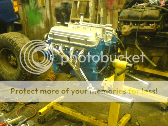

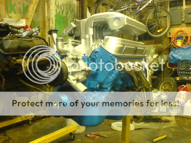

You conviently ignored the sentence about what you were starting with, didn't you ? :icon_rofl: A couple years ago I bought a 58,000 mile 68 Merc Monterey. It had the premium fuel 390 2 bbl motor in it(10.5 to 1 compression). My kids ran it for a few months, then we pulled it to rebuild it. All it needed was two pistons replaced (I had an extra set of these...390 flat tops) swapped the cam out for a Crane 272* Energizer ($125 thru Summit, with the lifters) Swapped the iron 2 bbl intake with a 428 PI unit (bought that one for $250) Also bought a set of FPA headers for the car (that was the most expensive part, but cost no more than any other custom header does @ $430 delivered) New rings, bearings and gaskets ran about $150. Total was less than many other rebuilds I've done. Point here is you do not have to buy all new off the shelf parts to go fast. A little shopping around here and a 390 cost no more than any other motor to build. If you're doing a 427 or 428, then yea, it's gonna cost you more,(if you don't shop around) than a 390 or any other motor. So, no I didn't get it backwards
