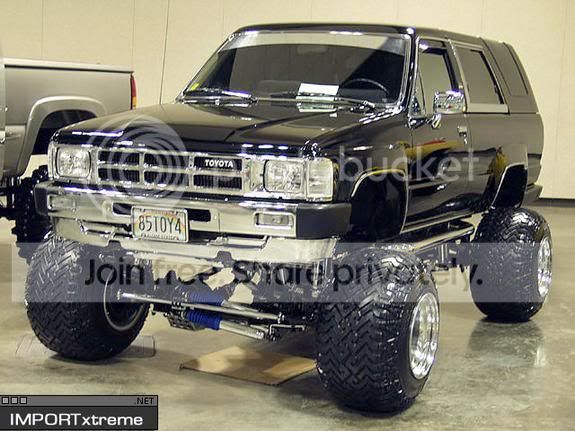

31x10.5 on 15x12 would kinda look like this
