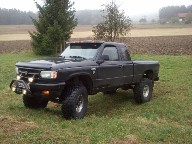

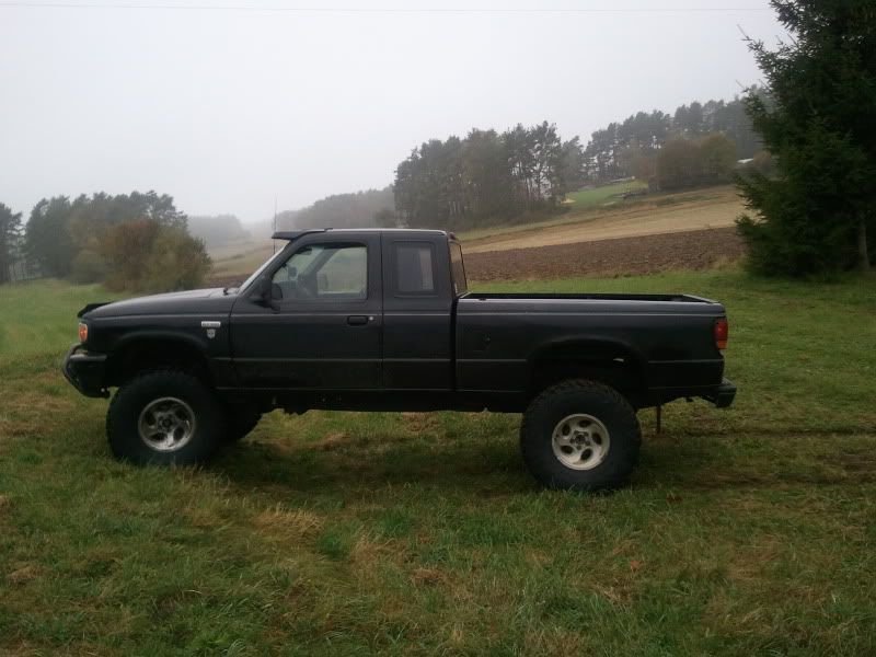

No probs. Pics do not even begin to show how big it is...I am 6'0 and it Towers over me now.

@weezl, it is at least 3" taller than before. Almost sprained my ankle getting out of it the other day.
by my math (provided stock we were level) you should be 7 inches taller than my truck... like i said, it towering over you HAS to be an understatement!
