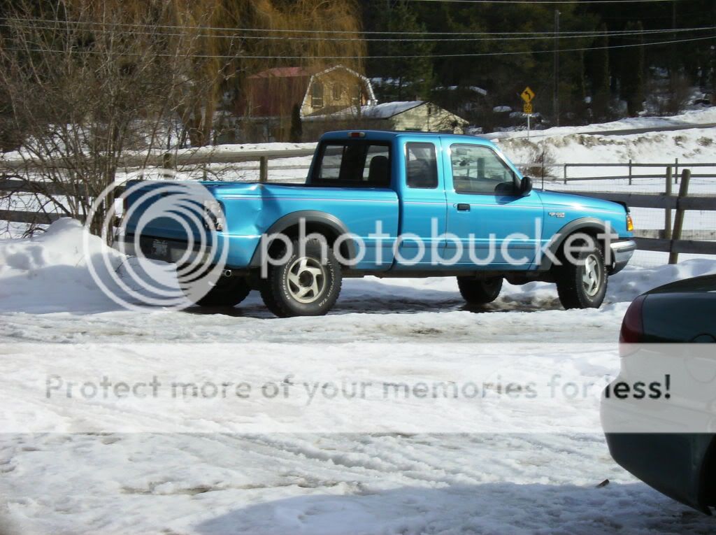

dont mind the dent. i took this picture a couple years ago when i borrowed the tires from a friend, rims are off an explorer. i have since got these tires from my friend and they are on my stock ranger wheels.
