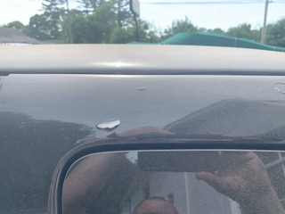

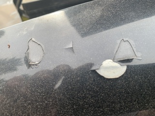

You can totally paint it yourself. There's even rattlecans now made for doing half decent paint jobs. They have a super wide spray pattern. Use a handheld rattlecan grip and it'll stop finger fatique/runs. Wait a week, cut it with 1200 grit (wetsand) wax and grease then do as many coats of clear as you can
The issue is it needs to be stripped. The truck has been painted before and it’s split and cracked all over the place.
