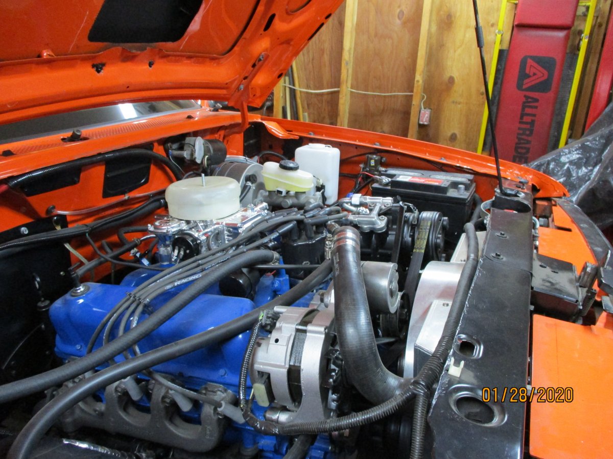

I can move the throttle 1/16 of an inch and feel instant response with a Holley carb, much better than EFI and drive by wire is even more sluggish. The key is properly setting up the carb and distributor advance curve. My 77 Mustang came from Ford making 139 hp with a 302 and turning 17.7 in the quarter- according to magazine tests- and struggled to get better than 12 mpg. The current set up has turned 13.8 @ 102mph and easily gets 20 mpg if driven like an adult. I swapped my son's shiny P.O.S. Edelbrock onto it once, the response was soggy
and it cost me 3 tenths. My Ranger has a 351 with a stock 95 F150 roller cam, 1.7 rockers, an Offenhauser dual port, and a Holley. It got a steady 16 mpg all summer doing a lot of in town driving. My 2011 Ranger had a 4.0 sohc and an automatic, was all original, and almost never got 16 mpg in town.
