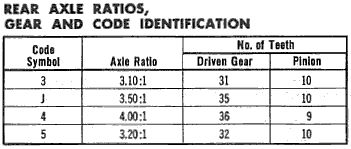

I think its the same thing if I am reading what was said correctly
example here
60383
So for a 3.10 ratio there are 3.1 teeth on ring gear(driven gear) for every 1 pinion tooth
4 teeth for every 1 tooth on a 4.0 ratio
And so the drive shaft must rotate the pinion gear 3.1 times to get 1 full rotation of the ring gear if ratio is 3.10:1
Or 4 times if its a 4.0:1 ratio
So same thing, tooth ratio and rotation ratio

It is incorrect to think that if your truck has 3.73 gears in the rear end that the driveshaft will turn that many times for every turn of of the axle shaft.
But it does... you can jack up a locked rear*, spin the wheels 1 revolution, count the number of turns the driveshaft makes, and it WILL match the gear ratio.
*On an open diff, you only jack up 1 wheel.
