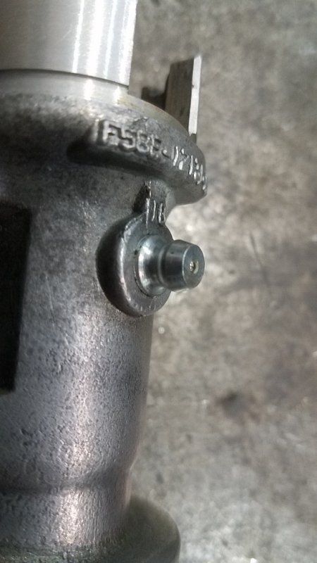

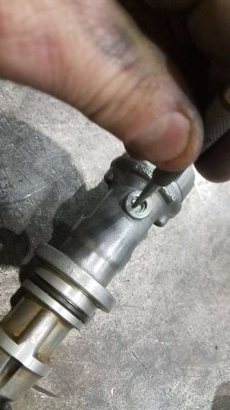

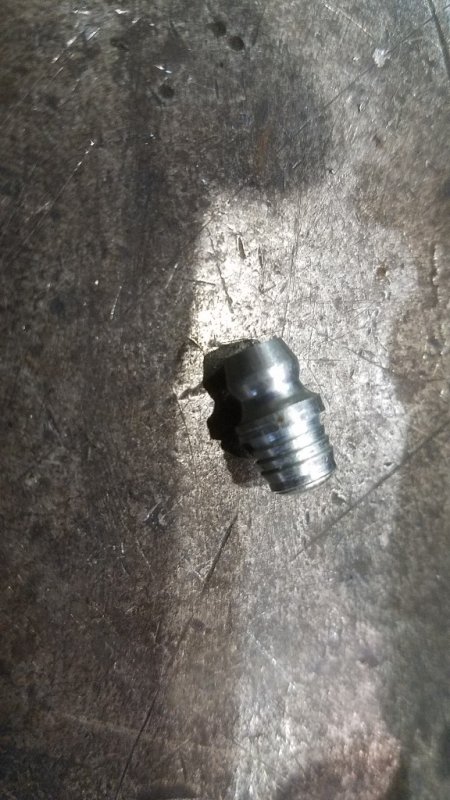

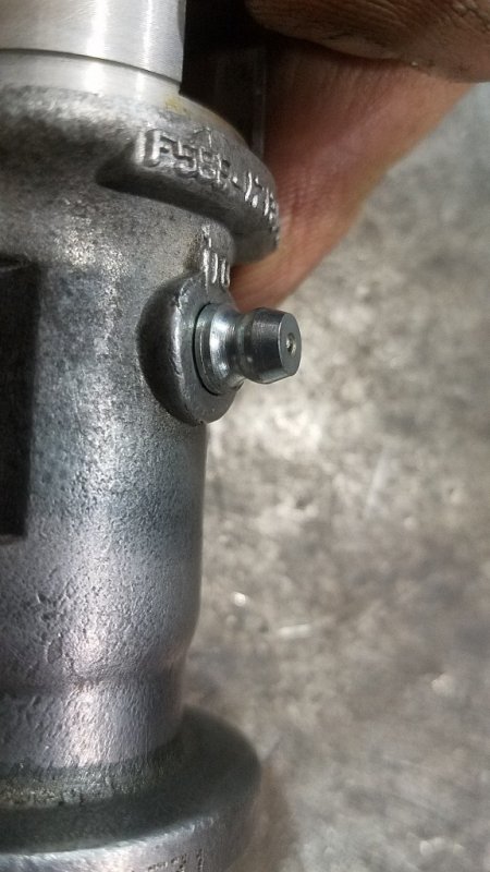

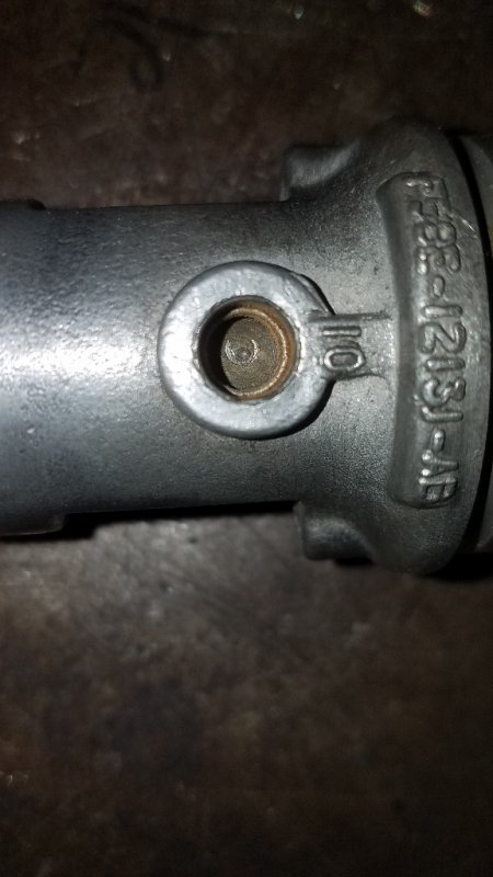

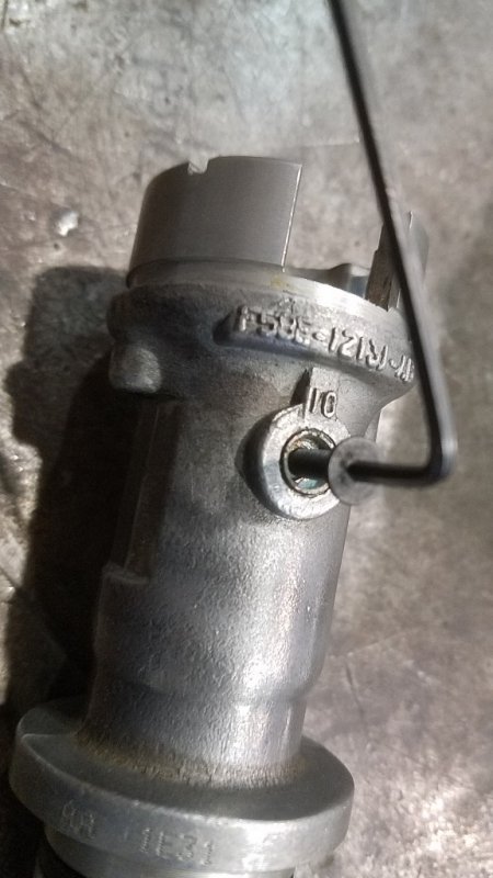

If you ever take a cam sync apart. There is a seal in the bottom half that has to be in there so it wont have a vacuum leak through the cam sync. This causes a problem because the top part of the cam sync has a bronze bushing that is lubricated with grease from the factory, the lower half gets lubed by engine oil. After a while and miles the grease in the top half dries out then the bushing starts wearing. With no way to regrease the bushing it eventually wears and causes failure. I install a grease fitting in all of my cam syncs. I have done the mod in 3.0l, 5.0l, 4.0l, and 4.2l engines. You only have to put a little squirt in there every 25k miles and it will last forever. The short of it. Remove the small welch plug in the housing boss on the side of the cam sync, clean any crud out, center punch the outside of the bushing, slowing drill a hole through the bushing till it barely breaks through )dont go too far because you will be drilling into the shaft), then install a hammer in zerk fitting, you can grease it forever after this, while it is installed.

Which way does the zerk fitting end up being oriented when installed?

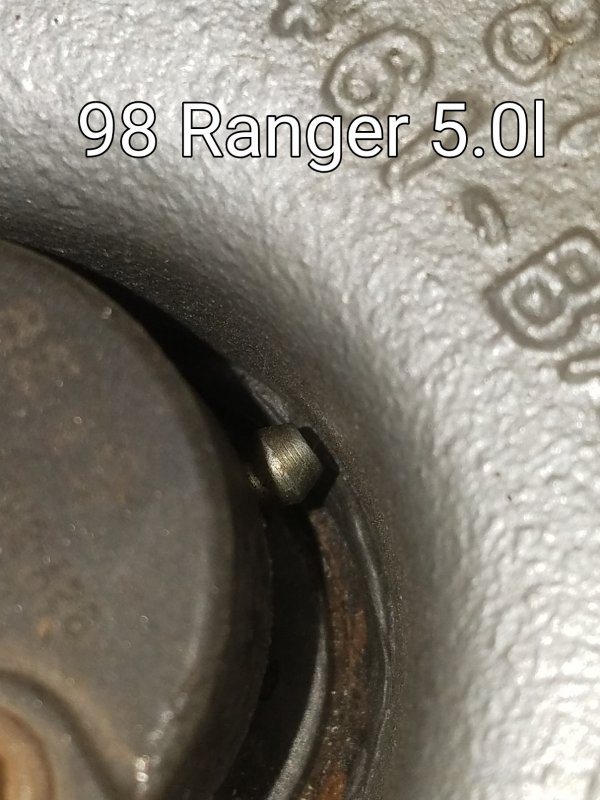

The 3.0l zerk points towards the cam sync hold down bolt. The 4.2l and 5.0l syncs i actually tapped for a screw in zerks. The 4.2l has a 45 degree but the 5.0l boss is in a gay location, directly in the back toward the intake. Its the easiest one to get to though. It can be marked in postion then turn the housing around to grease then rotated back to the mark and secured back down without removing it.
