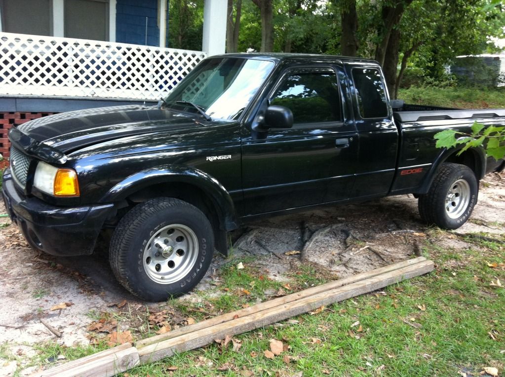

Heard a slight knocking sound when I bought my 01 3.0 for a seriously discounted price. A few months later, driving down the highway, the rpm's shot up and the power dropped out. I coasted to a stop on the side where the motor shut off (seized), got her towed home and there she has been now for longer than I care to admit.
Finally got some time to tear into her about a week ago and now I have got parts coming in like it's cool so I can get her back on the road. I picked up a 99 3.0 taurus bottom end to swap over and started cleaning it up before I surface it and the heads.
