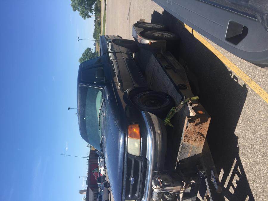

Thought I would post a pic of my new project
