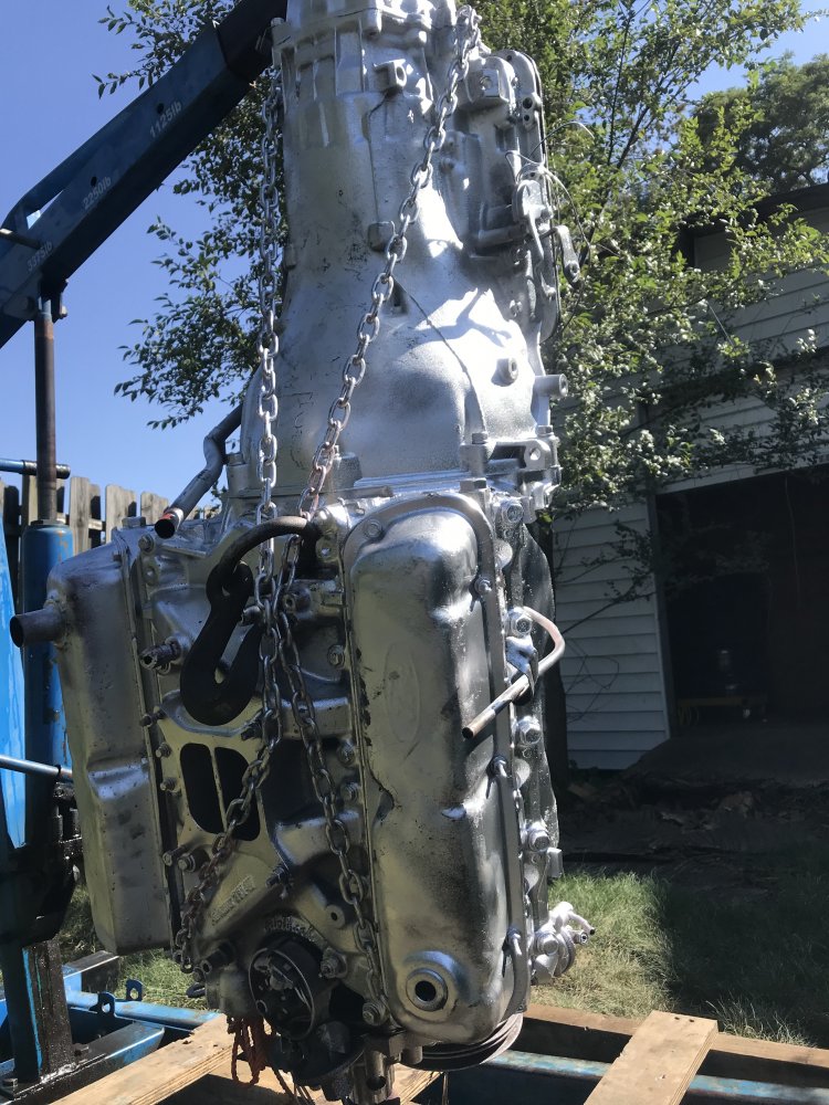

I’ll take a picture of the motor when I have it on the stand. Here’s what it looks like rn lolView attachment 65420
That looks like a 351...So do I have a 302 or a 351? And will I need to get different heads to fit the ranger
