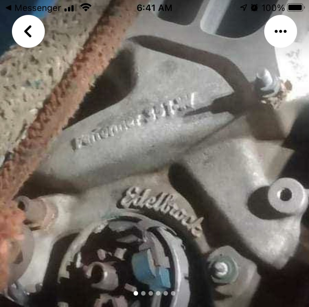

Update: I just got an 83 302 from an f150 if was a deal I couldn’t refuse and it has a 351 intake and comes with the carb. Do I still need to look for a 90s f150 trans / 90s mustang trans?
It can't have a 351 intake.
65381
If it's truly a 351w lower intake and it fits, then it's a 351 under it.
302 intakes are about 9" wide and 351s are about 11". If that intake bolted on it's a 351.
