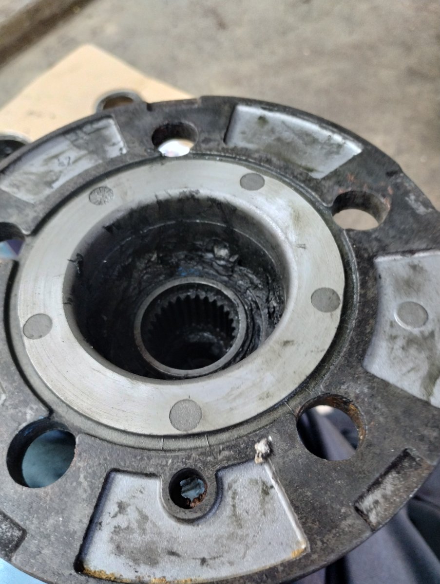

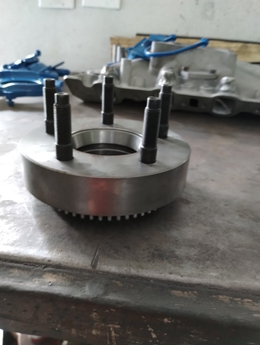

That's what the original ranger rotor turned into turned so the Vic rotor will slide onto it.

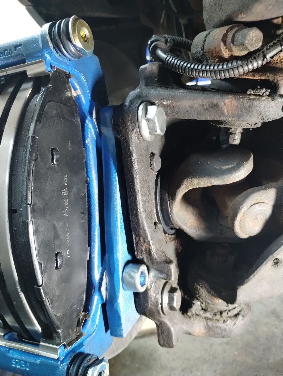

½" plate, to adapt the Vic caliper bracket drilled top hole to accept factory Vic caliper bracket bolt. The lower retaining bolt is the factory ranger bolt, and the lower vic retainer is in the 1/2 plate. Very straight forward simple set up, works very well. The hubs had to be turned in a lathe to be flat faced.

Just regular 1/2" mild steel plate? Nothing heat treated?

I am a industrial maintenance millwright so if the machinist has time he will take care of things like this for me. One of the perks of the field I'm in. But anyplace that does machine work with cnc, Bridgeport, lathe will be able to handle this.
Just standard 1/2" plate nothing fancy.
It should years ago I swapped my dad's ranger dto disk on the rear elongated bracket holes slightly but nothing crazy.

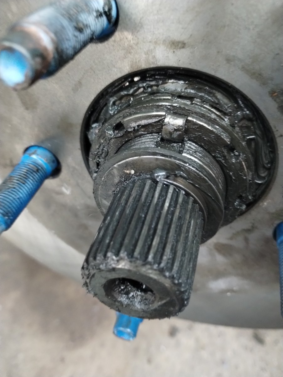

This set up has been together for 3 years, bunch of miles. Almost forgot about doing it. Also running stage 8 44 spindle nut my own retaining tab, and cut the ears off the snap ring.
