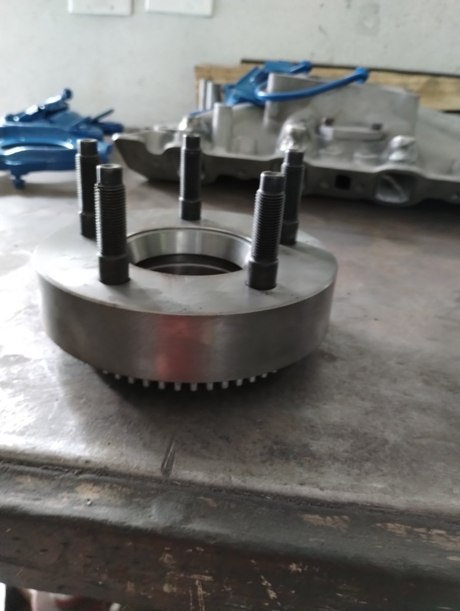

There's also a larger Cobra front brake upgrade, also utilizes the 95-97 Ranger D35 spindle.
