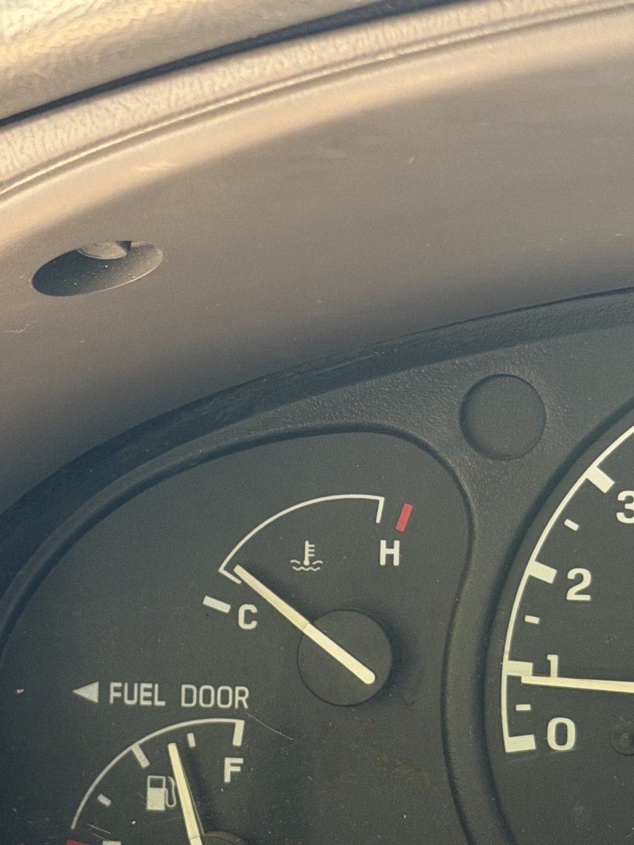

I cant get the temp gauge to go any higher than the photo. I plugged forscan up to it and a 5 minute drive around my town cylinder head temperature sensor read as high as 254 at one point and coolant temperature peaked around 230. are these normal temperatures? i swear the engine smells like its overheating, floorboards are really really hot. but again gauge wont go any higher than this and no CEL, no check gauge light for overheating. i also noticed it gets up to temperature extremely fast. im talking like idling in the driveway for 2 minutes and its already up to like 190 degrees cht. coolant is not boiling over. heater blows hot.

i should mention my old engine with 250k the heat gauge would go to the middle around the symbol and this one will not even though forscan reads the temperatures as very hot

I'm curious how this turned out as well. One thing to bear in mind is that these modern dash gauges don't give accurate readings, they're more like sophisticated idiot lights that favor a certain part of the gauge for feel-good effect. However, it is interesting that it sits in a different place than with the old engine, especially when Forscan reads so high. I'm wondering if it's a sensor problem, either defective or different spec than the other engine.

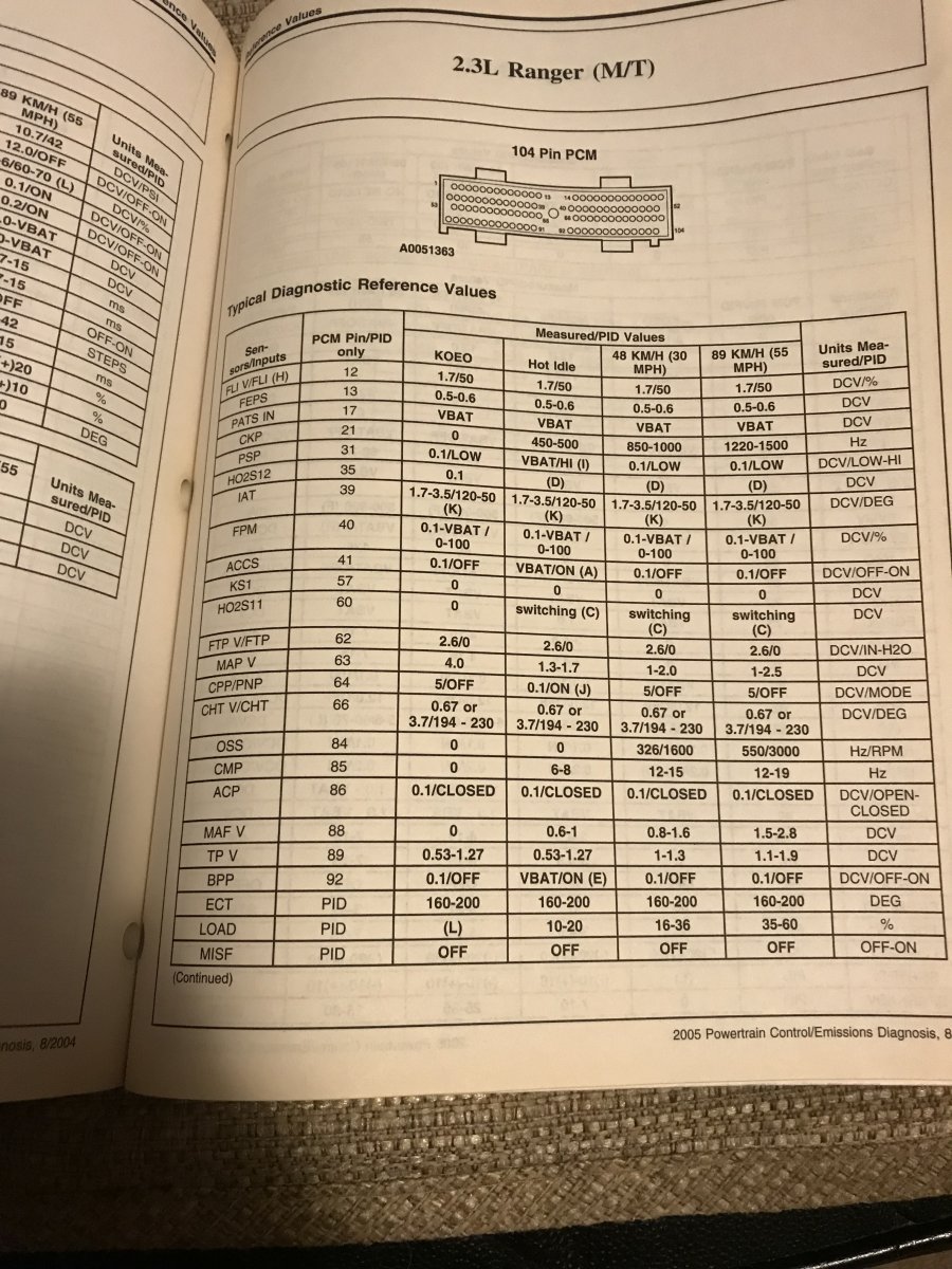

the diagnostics manual states 194 to 230 degrees.

this is from a 2005 manual. there may be some minor differences with a 2002.
