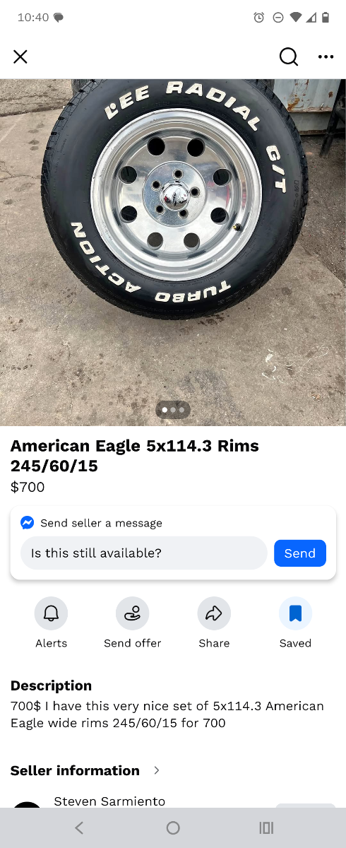

Hello everyone, so as stated in the title I'm wondering if 245/60r15 will fit on my truck. I searched the forums already and saw some evidence that it should be fine, but can't help to ask again.
I found a pretty decent deal on FB Marketplace for a wheel/tire combo for $700. I just bought my Ranger from an Air Force vet who hasn't driven it much in the last decade so the tires definitely need to be replaced (they're dated from 2014) and I figured I might as well get new wheels as well. I included a screenshot of the marketplace post for reference. Thanks in advanced

Just going off memory, 245/60 is about the same height as 235/75, just wider. My impulse says it should be fine but I have no direct experience.

I ran the size through this site: 1010 Tires Tire Size Calculator
It's only about 9.7" wide, so more narrow than the 10.5" wide 31" tires I run on the 2011. They will fit.
Being that the tire height is a bit shorter than the 225/70R15 that comes on a lot of the later RWD Rangers, your speedometer might be off by a couple mph. Run the size your truck comes with vs the size you want, to get an idea what the difference will be. Your year of Ranger came with a wide variety of tire sizes depending on the trim package(s) it came with. So, without getting into specifics here, we really can't tell you if there will be a difference or not.
Will definitely fit. I have 255/60/15s on my 93 with 8" rims. No problems.

Their fitting isn't the question: the question is their effect on performance:
Fitting over the spindle in minor concern, but a '93 2WD should have the small 2.5" diameter spindles and most <all> rims will have larger centers.​
The 245/60R15s are ~7% larger than the stock 195/70R14s; which will be the same as going from 3.73s to 3.45s. They're also ~2" wider (~25%), so the performance loss will be magnified by the size/weight increase (and Colorado Springs isn't exactly at sea level).​
Not saying don't do it; just be aware of the impact.

Good food for thought. Think I'm just gonna keep my stock wheels for now and just get some new A/T's and call it a day haha
235/60-15 was stock on 90's 2wd Splash models so a 245 should fit okay.
