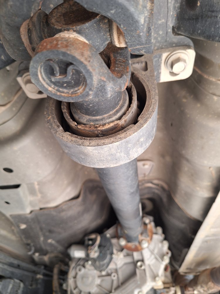

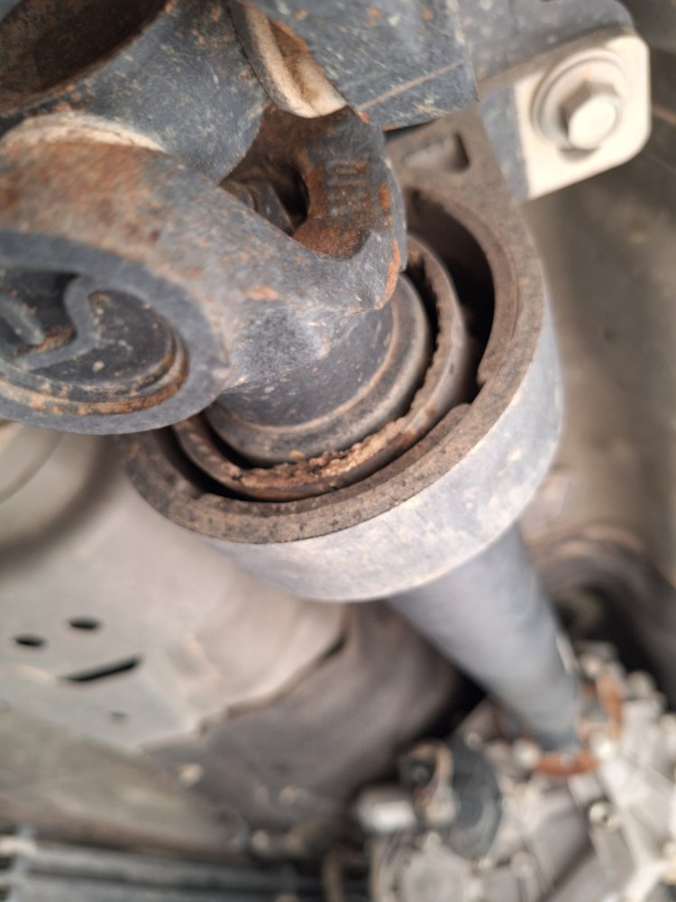

But I noticed something new today. I'm getting vibration (I think in the front) when I go over 75, and when I let off the gas and coast, the vibration intensifies. Seems like it may be in the driveline.
This has me wondering if it could be an issue with pinion angle since it has the 3.5"/1.5" lift, or a bad center bearing on the driveshaft (I actually have a spare).

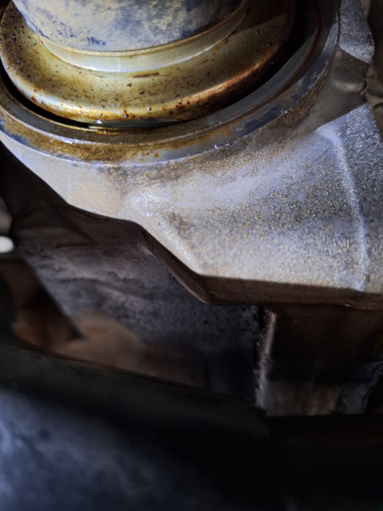

And just to keep things interesting, it looks like the pinion seal is leaking on my front axle.
