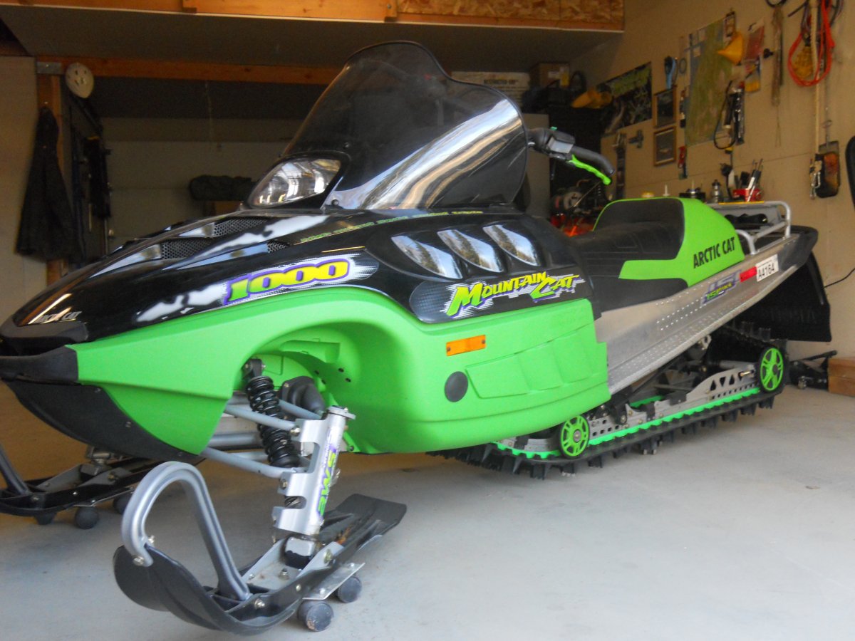

I think, short of installing a catch can, oil changes on my truck are going to be done a 3k intervals. The kit for the catch can looks pretty straight forward, and it makes sense that it would be a effective "separator" for the contamination present in the vacuum stream. It's a shame, that probably, most dealerships would complaint/threaten your warranty, if found on a vehicle brought in for warranty work. This "mentality" is present in almost every industry--I purchased a 2002 1000cc 154" Mountaincat from a Anchorage A/C dealer, who when prepping the unit, installed my MBRP exhaust can to the expansion chambers-(mostly just to make it LOUD) -- 36 miles into the first ride, the engine seized, at an idle, when I stepped off the machine to talk to my buddy-we towed it out of the backcountry, and when I called the dealership, they told me I had to install the stock muffler back on the machine, before bringing it in, so there would be "no warranty questions"!! everything is expensive, so I just did it.
