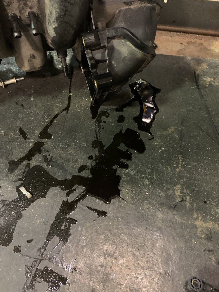

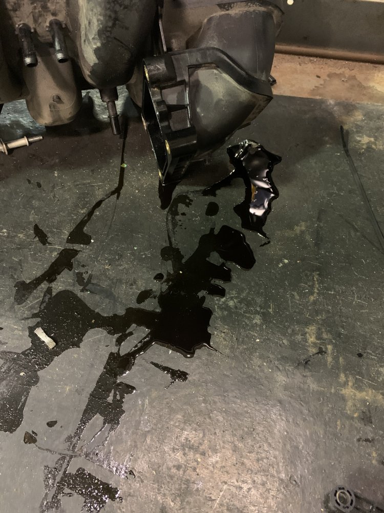

I pulled an intake off a ‘17 F250 6.2l...
35445
