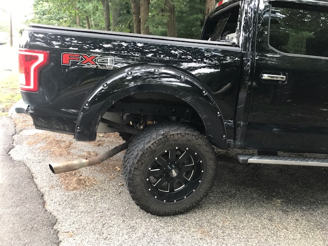

I’m from NJ... it’s not just the idiot in the BMW you have to worry about, the kid in the Sentra will do just as much damage.

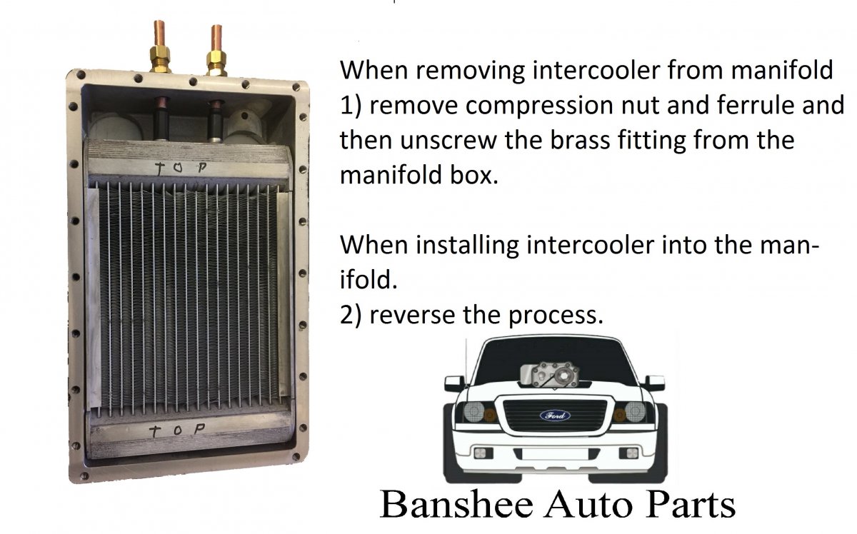

Anyways.... Caster sent me the part numbers, etc for his intercooler setup:
Part number F6.1x8x1.25H-15E29-P1326-01
Contact:
Andrew Keiderling
Inside Sales & Applications
Alcoil USA LLC
3627 Sandhurst Drive
York, PA 17406
Office: 717-347-7500
Mobile: 717-891-7980
Email: Andrew.Keiderling@alcoil.net
<image006.gif>
Website: www.Alcoil.net
Why is no one making a blower setup like this for a Ranger?
