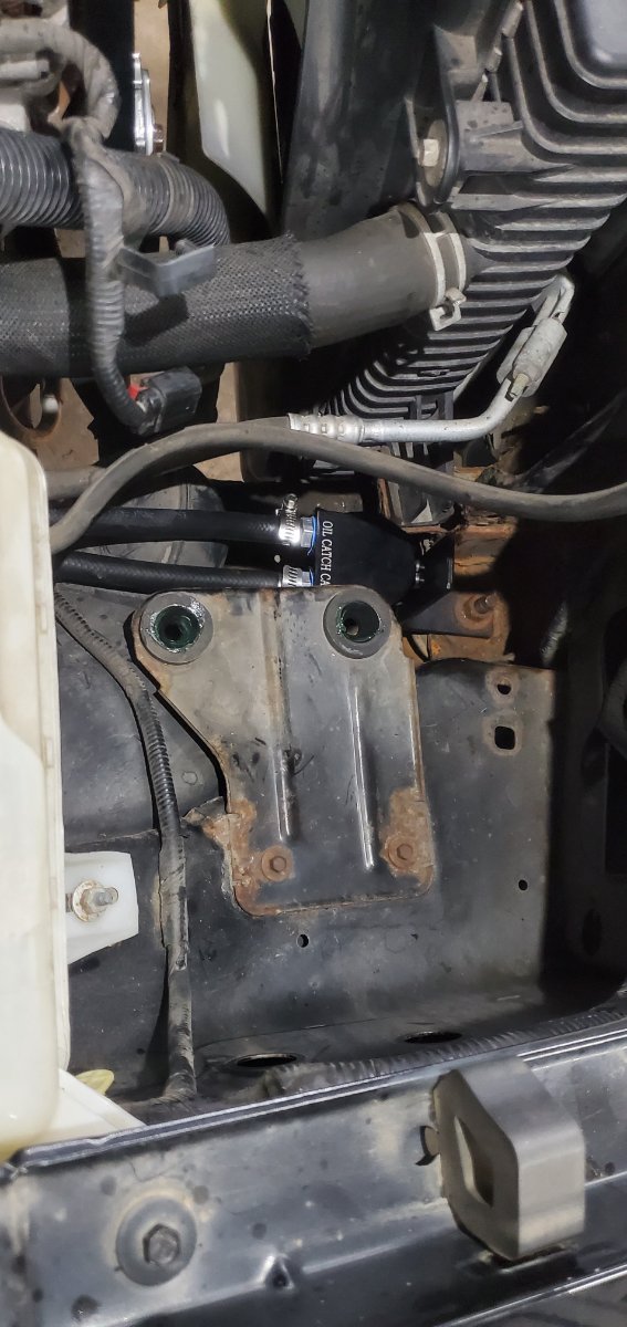

I wouldn't look to close at the core support... but maybe they corrected that by the time they made yours.
When I owned a small company I would lease a new truck every three years. I had my old '05 Sport Trac nicely built but the core support was rusting after only three years. I had planned on buying it when the lease was up but I pulled all the parts off of it and got my '08 Trac. The '99 and '02 Rangers I had before both developed rust on some of the bottom door seams and the bottom tailgate seam, some of which were fixed on warranty.

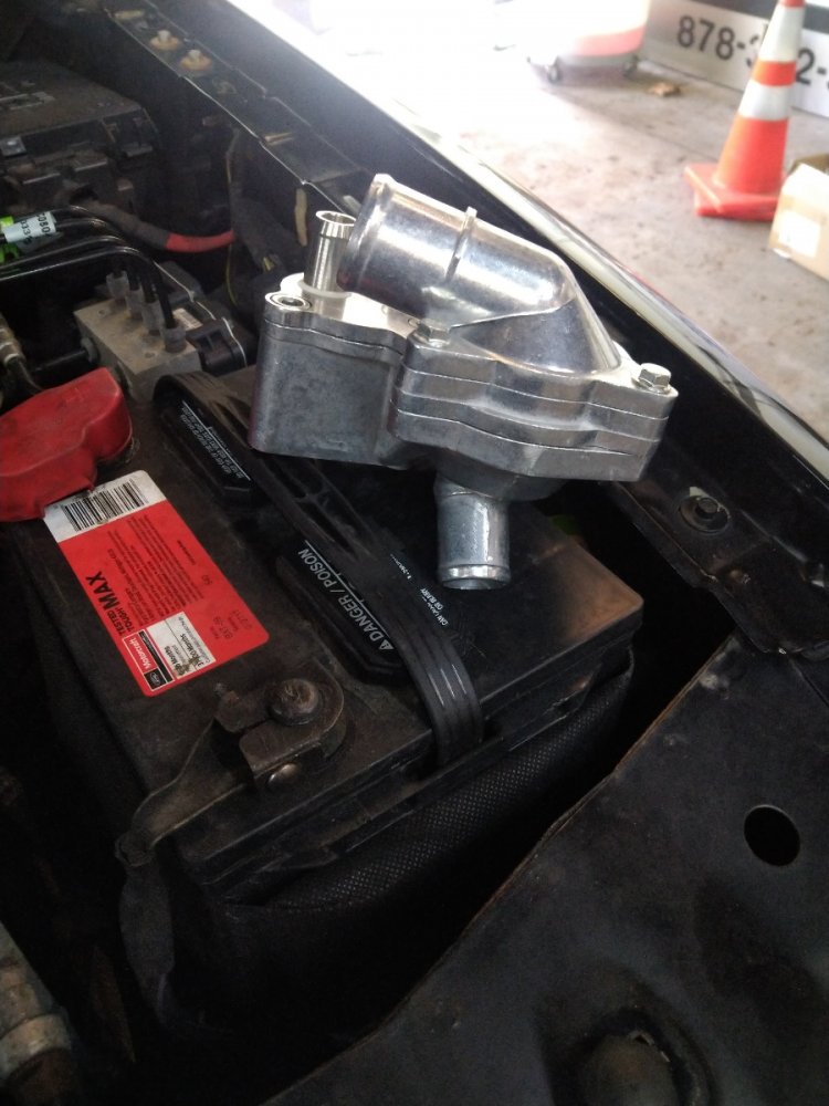

SKP aluminum thermostat housing and new Motorcraft ECT sensor.
Worth doing if you ask me. My plastic housing dripped exactly one time that I noticed, so took care of the issue before it became worse.
$26 on Rock Auto IIRC for aluminum housing with 192 degree thermostat installed. Part number was SKP SKRH144C.
Truck runs a bit smoother from the new ECT and thermostat, but now to figure out how to burp the system....
That's a good mod. The radiator tanks are still plastic. Check your radiator cap psi. Not sure about Rangers but on the Sport Trac boards we found that later models came with a 20 lb radiator cap which is too high. Swap the cap with one for a 2000 Mustang V6 that is 16 lb. I've been running one for years.
