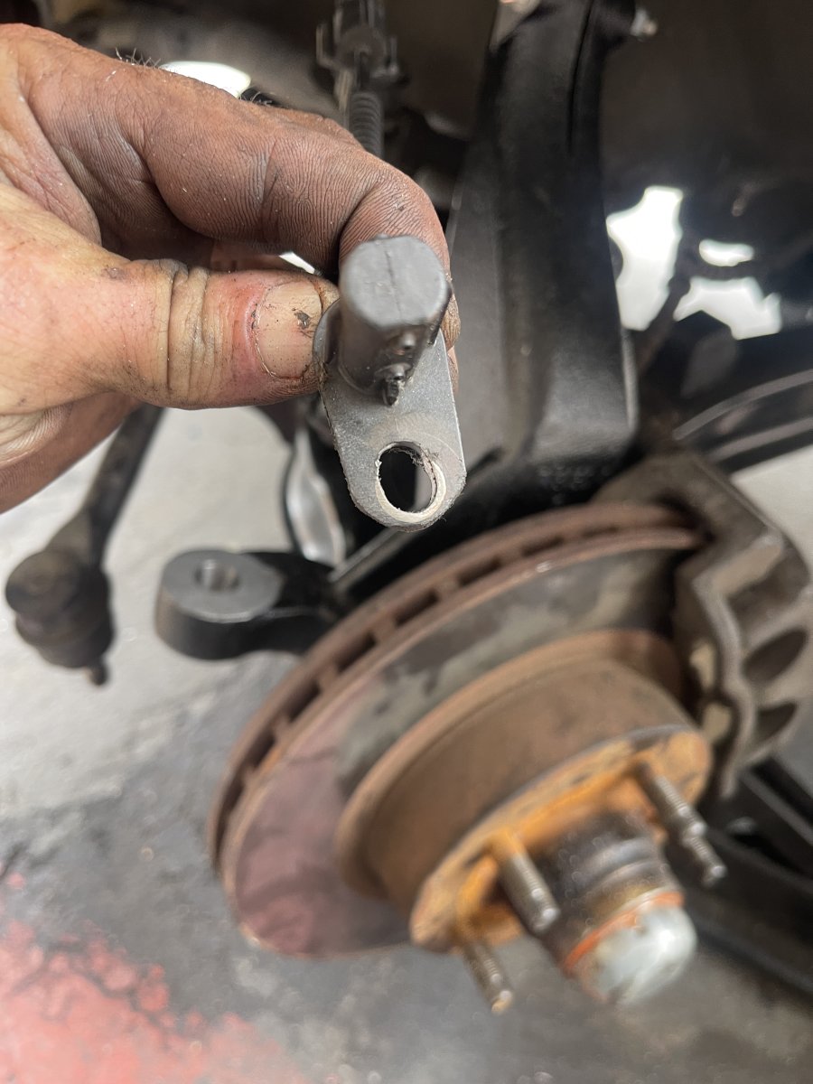

@slater50 what about suspension/shock down travel? As far as I've read if you keep the OEM (performance) shocks one won't be able to lift the truck using a suspension lift without losing shock downtravel so the truck would be a brick on the road.
Please, provide a feedback about that and/or let me know which shocks you installed along the larger spindle you showed in the pictures (I'm guessing it's a larger one lol).
I bought KYB Gas-a-Just shocks and the following suspension lift kit:
And I immediately figured out that I had f***ed up because I'd have zero downtravel on the KYB shocks if I lifted the truck using a suspension lift kit instead of a body lift kit.

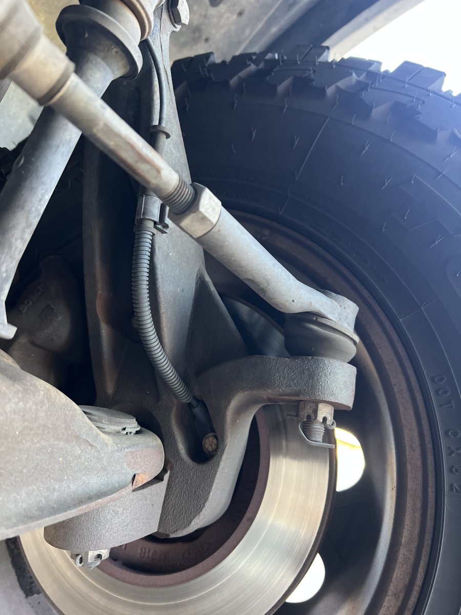

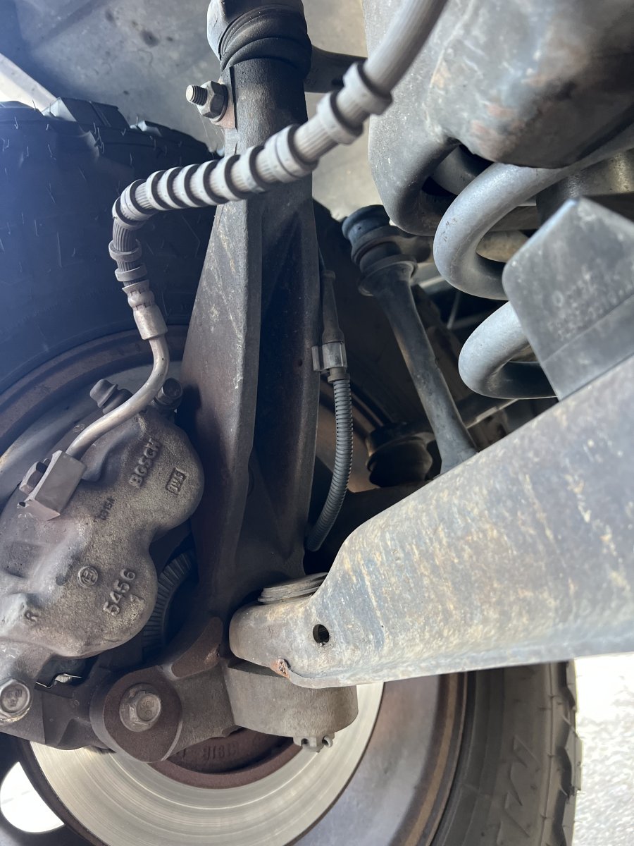

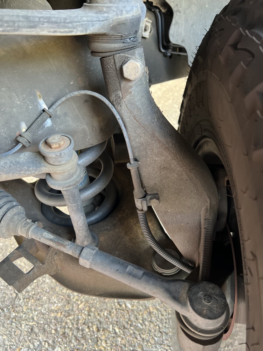

As I stated, I installed a spindle lift, no longer shock needed as keeps the stock geometry but I did also install new Wulf shocks to get some ride quality improvement which I think did make it less bouncy...
You did a spacer lift & suspension wasnt my thing at work, im assuming you need a longer shock....
Thats the crappy thing about spacer lift especially 3"'s you loses down travel.

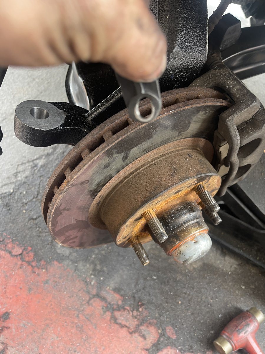

yup, you're right. I had to compress the coil spring in order to put the upper nut onto the KYB shock.
I feel so dumb, I asked you about the shock stuff before I understood how spindles would work. I just watched a video about it works and realized that is the best way to go, specially now that you provided the details about what to do in order to make traction-control/advancedtrac to work.
