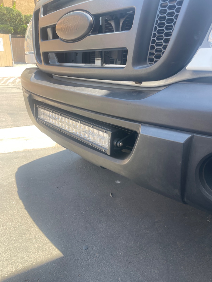

Also installed a 22" auxbeam 5d lightbar "12k lumens" in the lower area of the front bumper, tucked in where the front license plate use to be.
Dont have pics at the moment, but not very impressed with the light output...
Guess it is what it is with a $60 light bar.
Its blinding when you look at it but it definitely isnt making daylight.

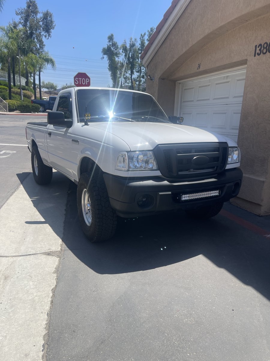

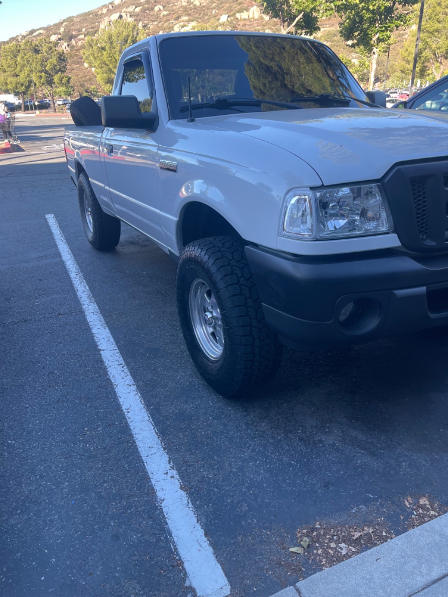

How much of a lift did it need in order to fit 31" TIRES?
The 31’s / 265 75 15 may fit a stock truck with maybe some minor rubbing, there’s also lots of YouTube videos on the matter. A ranger is a ranger, doesn’t matter what year it is…
I installed a 4 inch front spindle, did absolutely nothing in the rear…
Went with Wulf 4" spindles.
Theres also companies that make a spacer lift that goes under the spring by Torch, seems to be a very popular option....
Theres an eBay company that makes a 2" lift using a replacement coil spring, etc....

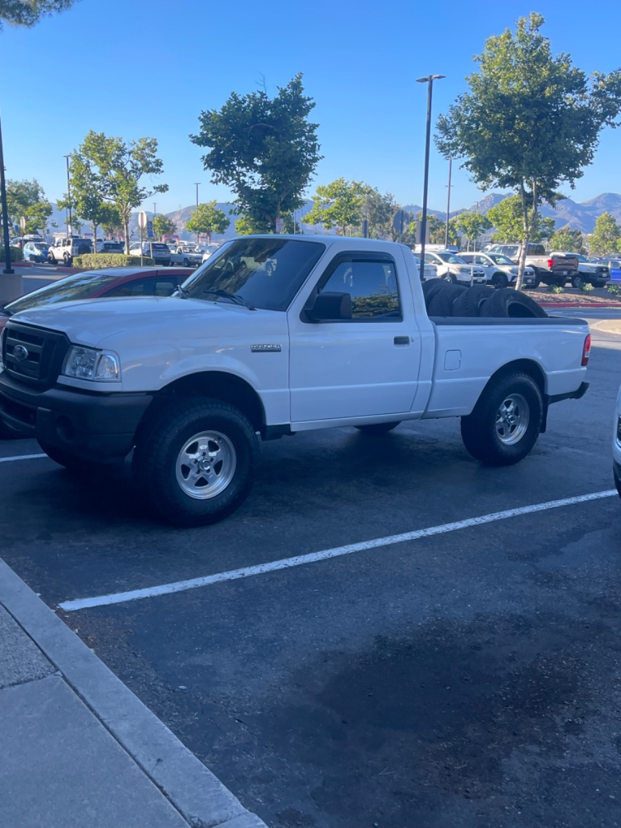

Front sits slightly higher than the rear but thats the stance I was looking for, son is tolerable of it since its subtle....
I hate the squat but the wheels look awesome. Classic drag racing aesthetic.. exactly the wheel I'll be putting on my 96.

I dont dislike the wheels but wouldnt have been my first pick, white & black looks better in my opinion...
& a deeper dish would have been cooler...
Mom would have my head if I put some Methods on her........
I did enough, it is what it is....
The rake looks more extreme in the pics, angle of the photo, tires in the rear, etc....
Out here in San Diego every cool kid in highschool is running a ranger & talked to a kid who's running a 1.5" block in the rear & he's sitting totally level....

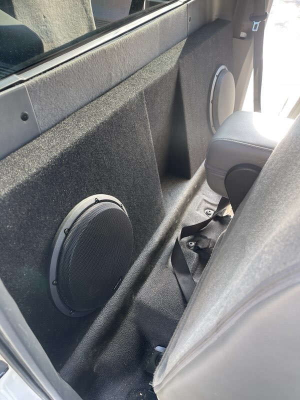

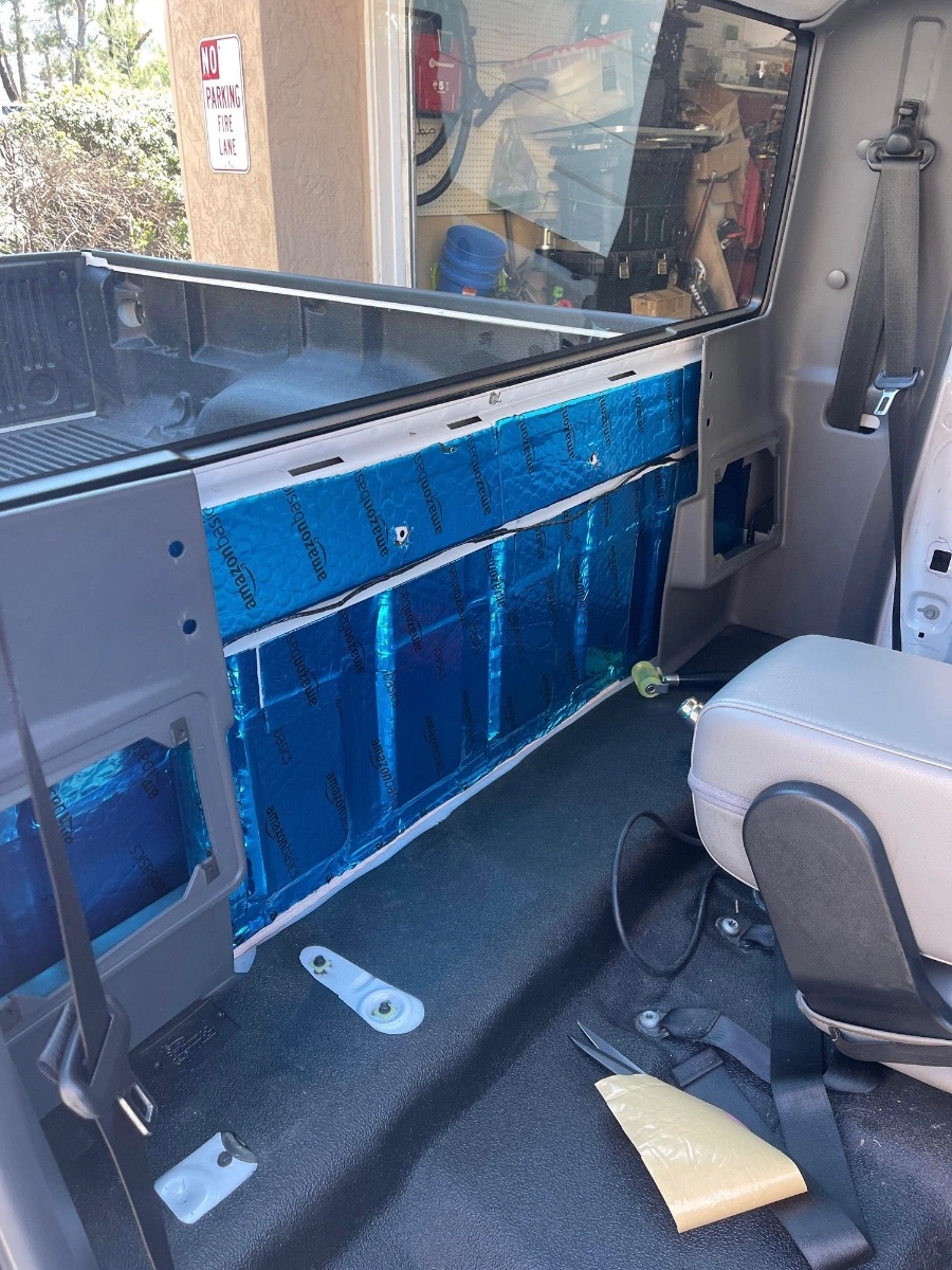

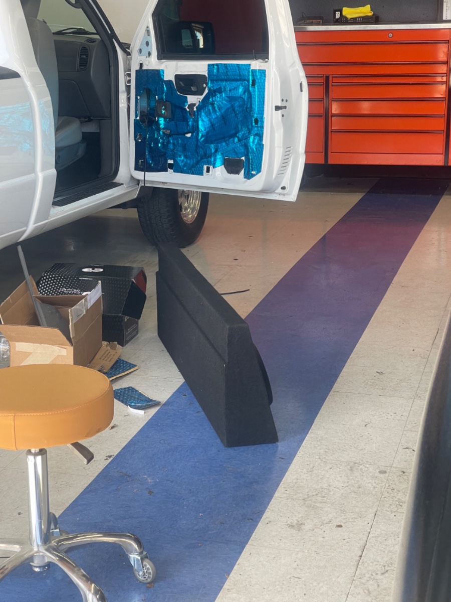

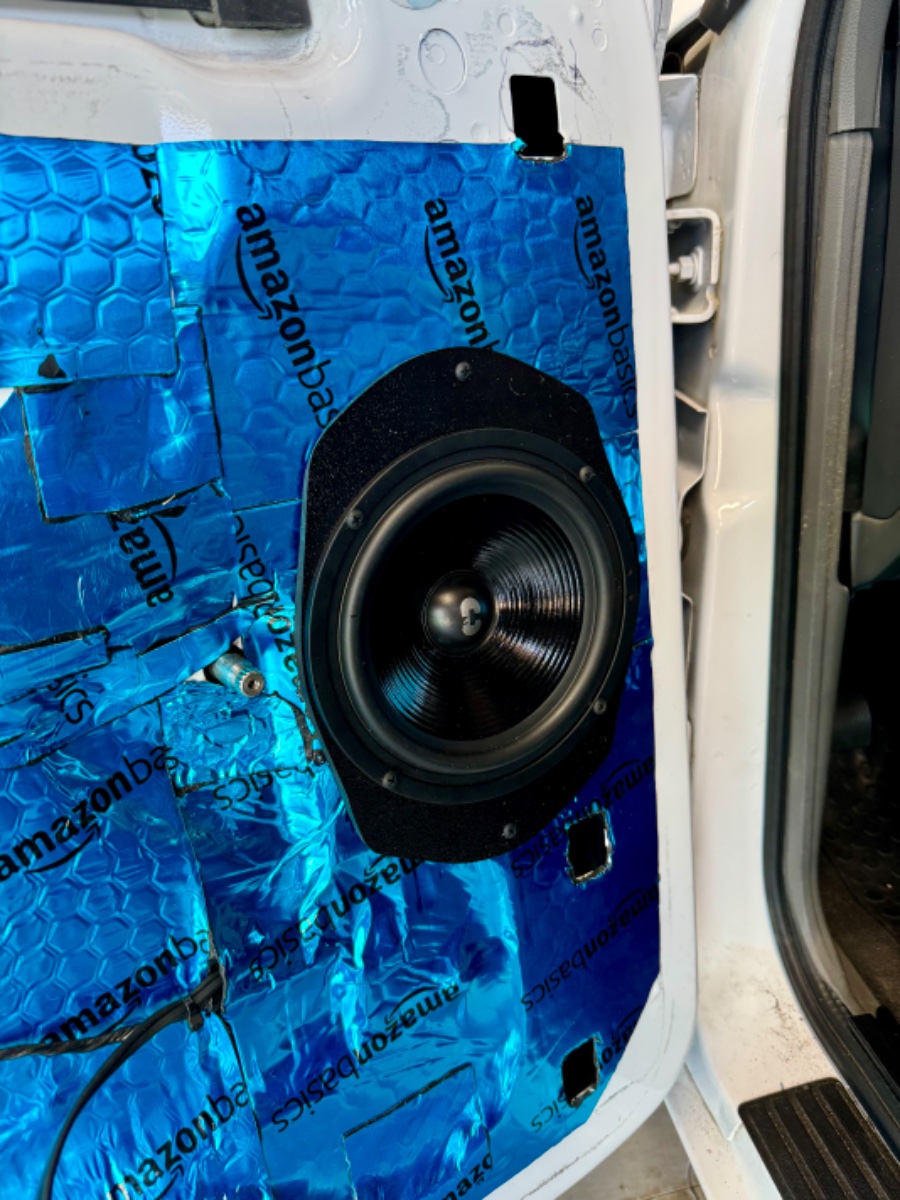

6.7" Cdt hd-62 2way
2 10" hertz mille pro 250 subs
kenwood 7" deck
Recoil 1800.5 amp running the entire system.
Had to raise the drivers side seat to the moon to make the amp fit.....
Kids beyond stoked & grateful....
