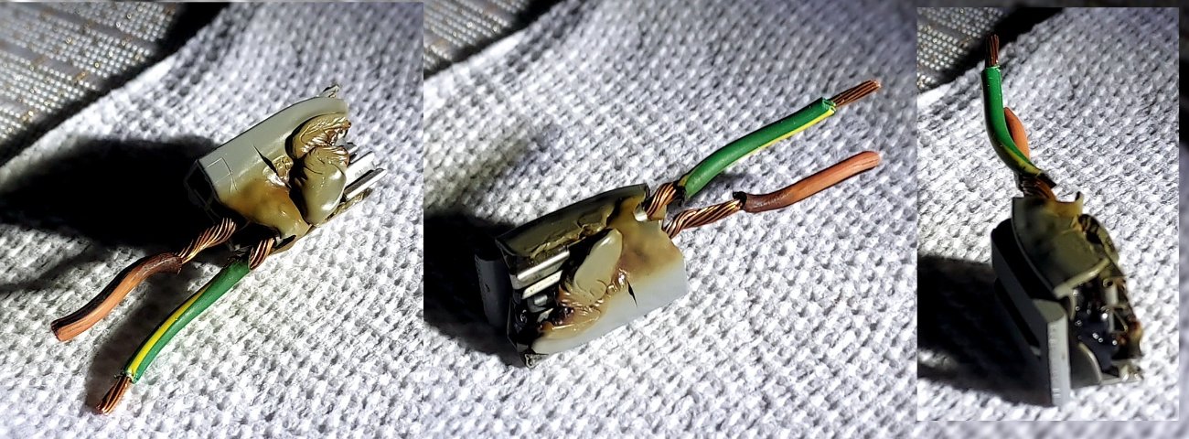

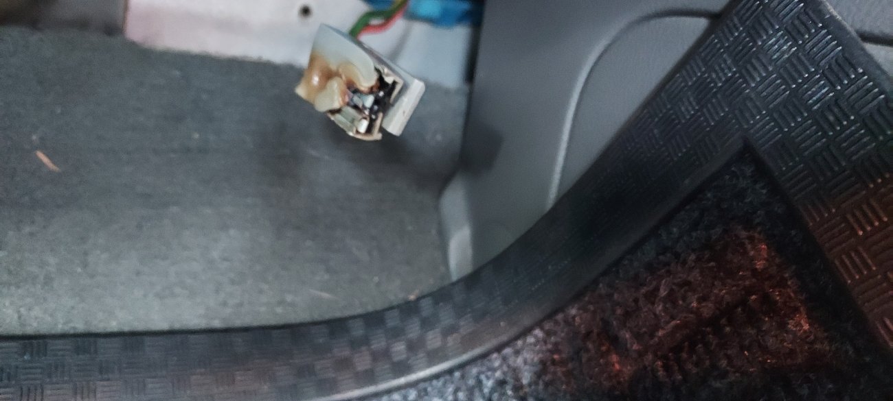

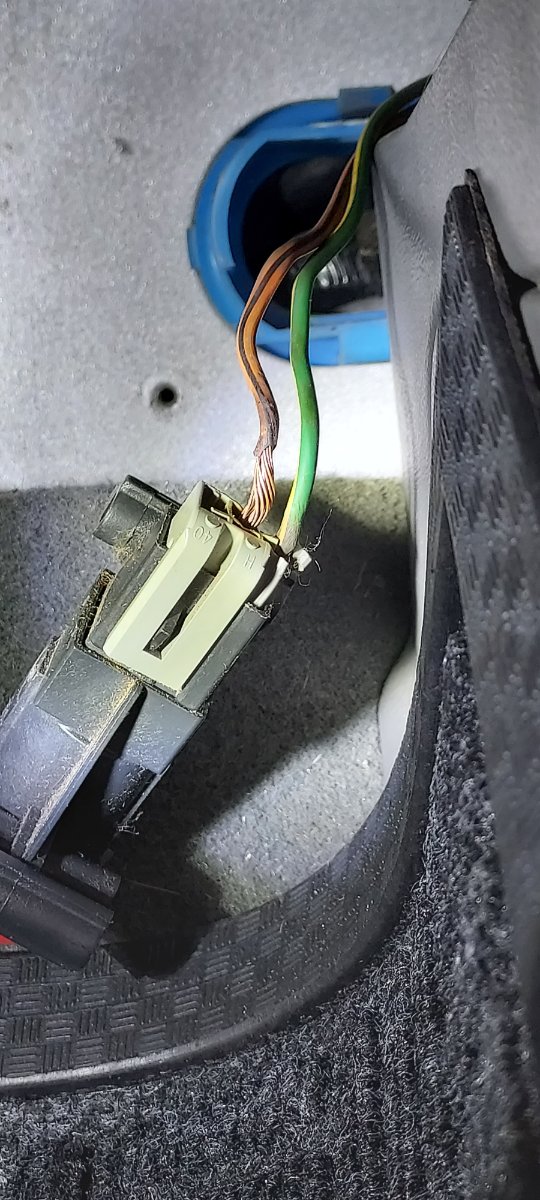

I have had intermittent crank no start issues with my 2004 Ranger 3.0 V6 XLT SuperCab with 100K miles. I am close to figuring out the whole problem. The other day the crank no start happened again and using my knowledge that I have been able to google I found the suspect major contributor. I am uploading photos showing what I found. During my trouble shooting this time, after getting the truck started, I happened to reach up under the dash to check the FPIS after the truck had been running for about 2 minutes and noticed the wires going to the switch were very hot. I'd guess at least 130 degrees F. I shut the truck off and dismounted the switch from the firewall, and the pics show what I found. This is a very serious fire hazard that any Ranger/Bronco II owner should be aware of. I have a good relationship with one of the local Ford service departments and plan to be working with them to go any further to resolve my issue. The intent of this posting is to get the word out about this condition and that any and all Ford vehicle owners of the mid 1990's to about 2011 should inspect this FPIS wiring and connector. For my 2004 Ranger this component is on the inside firewall just in front of the passenger's foot area under the dashboard. Likely in a different location on any ford of this era. I will add updates to this forum with my progress in resolving this issue.

toasted wires on that switch are very common.
since only the ends of the wires are toasted it's the connection that's getting hot
replacement pigtails are available. do the switch too.
the PCM monitors the voltage at the switch, if it doesn't like what it sees it shuts the power off to the fuel pump.
It is not just the wires are toasted it's the whole connector and wires at the connector at the FPIS. Obviously, something that has developed over time. I like that the pigtail can be purchased and hopefully after that repair will fix the whole problem but my experience as an aircraft mechanic makes me think that there's more to the obvious repair. Why over time would this condition occur? Wires too thin - fuel pump motor too big and or something introducing resistance/impedance in the wiring causing the heat? I feel lucky, based on the condition of the wires and connector that my truck didn't catch fire! I do have other thoughts about ALL of that. My main concern is that it's not just toasted wires to me and can be replaced with parts - there's the why...

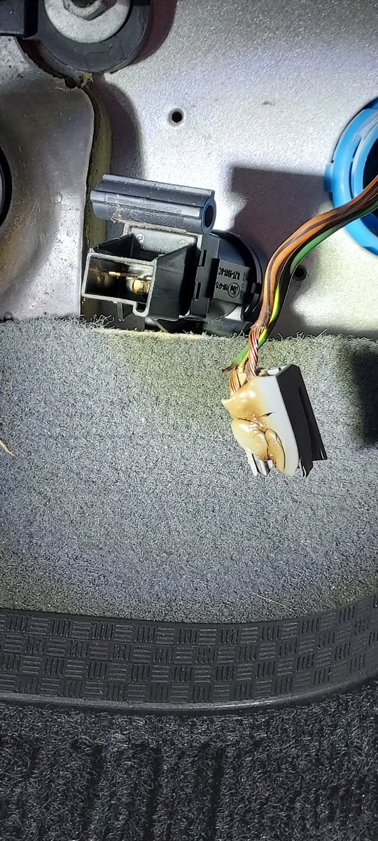

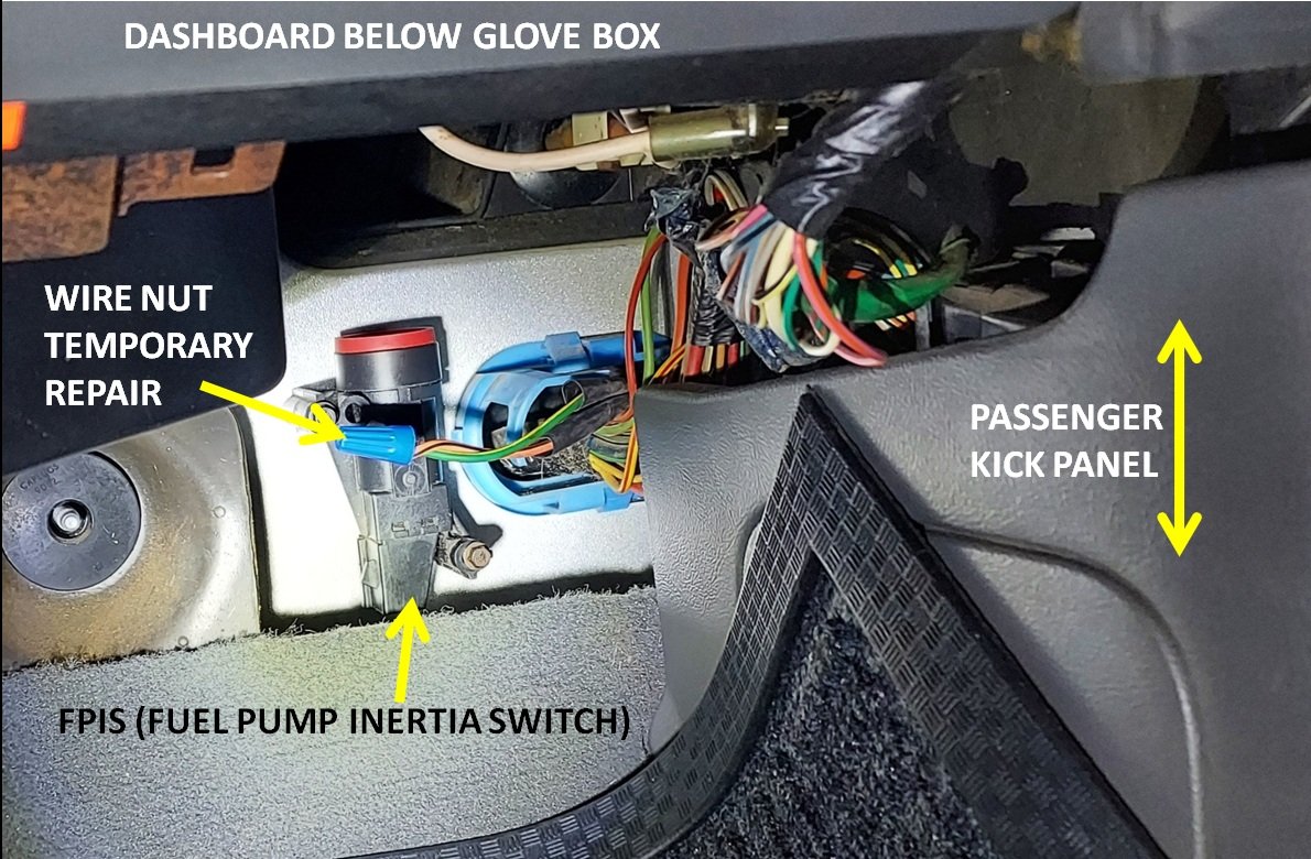

I appreciate your inputs. What I decided to do first was to put a jumper bypassing the FPIS. Easier said than done!!! The particular location on my truck after snipping off the wires, stripping the wires, and making the crimp with an electrical BUTT connector was a big challenge to make physically - just not enough room/space to HOLD the crimper tool and wire and crimp steady long enough to do it right/correctly. I consider myself a fairly small human and can't imagine the dexterity that it took for me, or any other human, to get in the positions that I did to make this fix! After 2 attempts with a crimp type BUTT connector, I gave up and put a BLUE electrical wire nut on the two 16-gauge wires to make the connection. My intention was to TEST whether the heat on the wires would be present while the engine was running after putting in a JUMPER. Success!!!! Wires did warm up a bit in the way I would consider normal. There is no way in he*l that I can install the pigtail connector. At least my truck is drivable at this point. In certain terms it is a nice truck. I have come to the realization that I am getting too old for this SH**. Not like I'm giving up ... AND the idea that If I really need a reliable source of transportation I would still stick with this one. I trust it and myself for whatever WE will need to do drive us forward. I am uploading some PIC'S that I hope will be helpful to anyone with a Ford vehicle of this ERA.

Apparently, the wires to the Fuel Pump Inertia Switch (FPIS) would lose contact but would reconnect after a period of cooling or the monitoring that the Powertrain Control Module (PCM) does of that circuit was disabling the fuel pump relay. Since the wire nut that I made the connection with, and the wires are not getting hot now, I will likely get the pigtail and install it using wire nuts. That pigtail is about $75 at a Ford dealer but I am going to attempt convince them to just give me a pigtail by showing how messed up my connector is. This is my final solution and hope that this thread is helpful for others to troubleshoot a Crank No Start problem. The is a link to the diagrams and explanation I used to help me understand how the FPIS fits in with the fuel pump system, but I am not sure it is actually specific to the 2004 ranger. https://techschematic.com/2004-ford-ranger-fuel-pump-wiring-diagram
While you have it apart, make sure the connections for the interia switch are good and clean, unless you plan to replace it as well.
I can't remember if you found the source of the water that caused the corrosion in the first place. If you haven't it might not be a bad idea to seal the back of the connector with some RTV and maybe coat the outside of the connector, not the pins themselves, with some dielectric grease to prevent future water intrusion.
