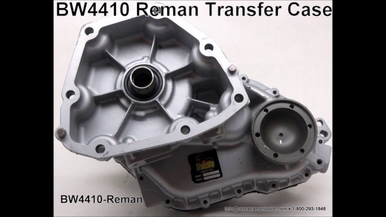

No, the 2004 Explorer used a Borg Warner BW4410 or BW4411 transfer case and its mounting to the transmission looks much different that the M5OD-R1 manual 4x4 trans mounting
Rangers used the BW1354 transfer case
BW4410 transfer case, transmission mount: https://i.ytimg.com/vi/vxqovtIt02Q/maxresdefault.jpg
Not round
