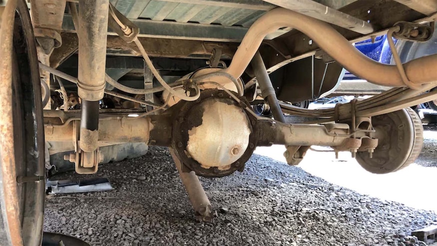

I've never had trouble with either drums or discs. I've had the Ranger for just a year and a half. One of the drums stuck once while I was backing up and for just a little while. I've had similar minor issues with discs on my car but only during the cold and only once in a great while. My original question was based based on my plan to upgrade my front discs. I thought that if they stop the truck a little faster, maybe I should make some attempt to make the rears stop faster too.
Even an Explorer axle with drum brakes is an upgrade for almost any Ranger. Just make sure if you got four wheel drive that the gear ratio is the same.
I don't like to do this, but I'm going to be relaying information that I was told but never verified. I was told that drum brakes are much more desirable for mudding or off-roading where you would get your Hub submerged in Mud or water at times, that the drums protect the brakes as opposed to the calipers with disc's getting wet and being harder to stop and or all muddy with sand another debris caught in the brake pad.
True to a point. Drums aren't water proof, so some gets in but not at the level of exposure discs get. Slotted rotors help clear the dirt, mud, and muck better than not having slots. So what you say has some merit but with enough exposure, you get quite a bit of crap in a drum brake and when that happens, they don't clear like a disc will. The chances are way lower but not zero.
