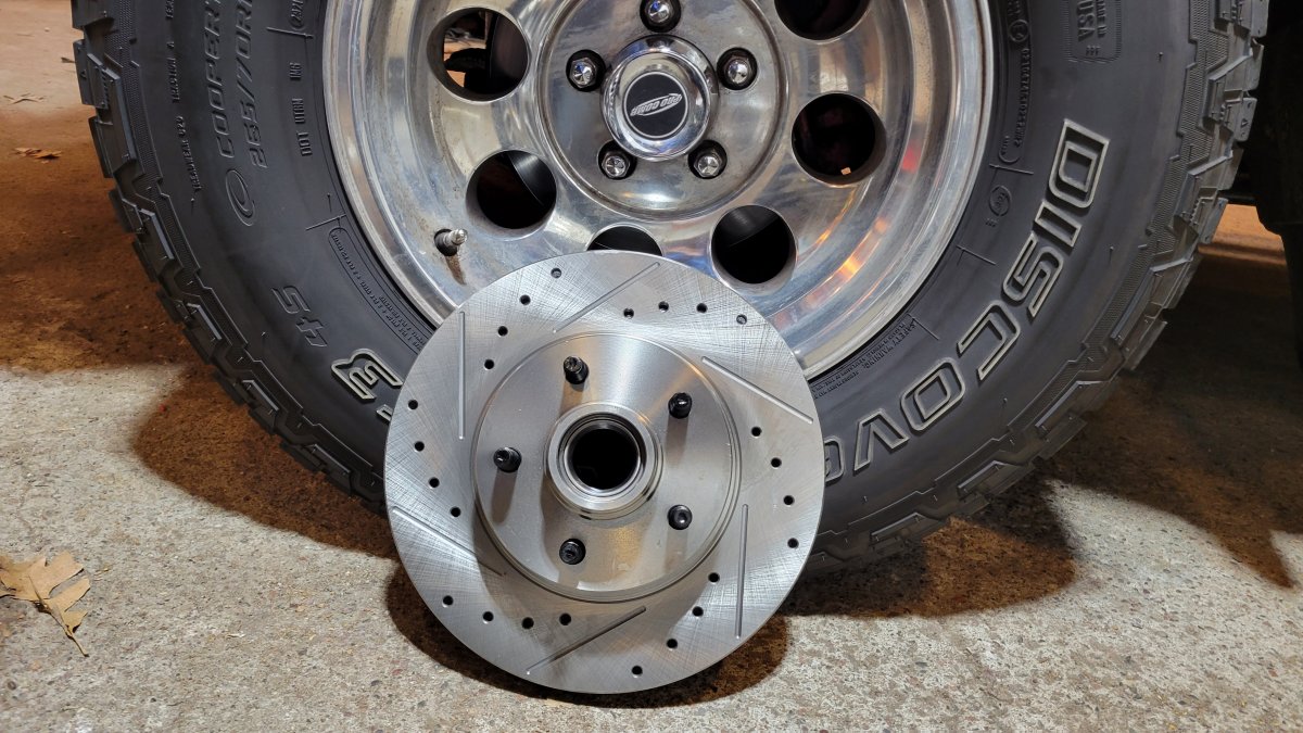

Thus far, good sirs, I've received a lot of sage advice here. So I dare ask for more. Slowly but surely, my 2003 Ranger has been nicely restored, even upgraded, making it a real keeper. This weekend I'm planning to do a brake job on the front. I am about due anyway. Why not upgrade again? I plan to swap the old discs with slotted and cross drilled, thus improving my stopping distances. It shouldn't take long, maybe a couple hours.
I've got bigger tires anyway. Why not put them to work?
I need to do the back drums too, but I might wait till spring. I saw this nice little article on switching out the rear drums for Mustang discs. https://www.therangerstation.com/tech/ford-ranger-bronco-ii-rear-disc-brake-conversion/ It might be possible even with my limited skills.
The easiest way would be to buy a kit. I saw one for $440. That's a little pricey. Granted, I could maybe find a rusty Mustang version at a junkyard and pare the price down.
Either way my question is the same. Is it worth it? Have you done it? Do any of you know if your increased stopping power was worth the time and money?
