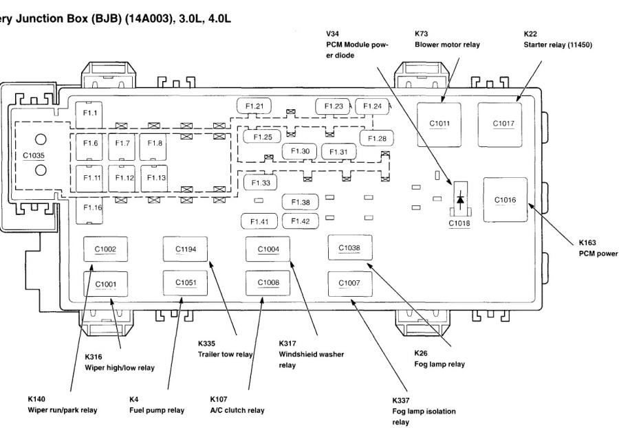

OK so after all this time and $180 spent ($120 was vacuum + Freon) I discovered from another guys question on just answer that it may be worth checking the ac clutch relay ($11) and that was the problem. Hopefully my troubles help somebody!
supposedly and 2002 fuse box used in early but not late 2003 models?
