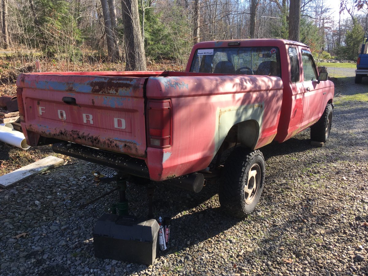

Some vehicles you can get away with making an access hole (Bronco II), but where the pump is at in a Ranger, it’s too close to the front of the box. You need about 2’ of room to work on the pump, but that can be achieved with the bed balanced on the rear tires and back bumper. With the tailgate off, the bed is nose heavy enough that it stays put just fine.
