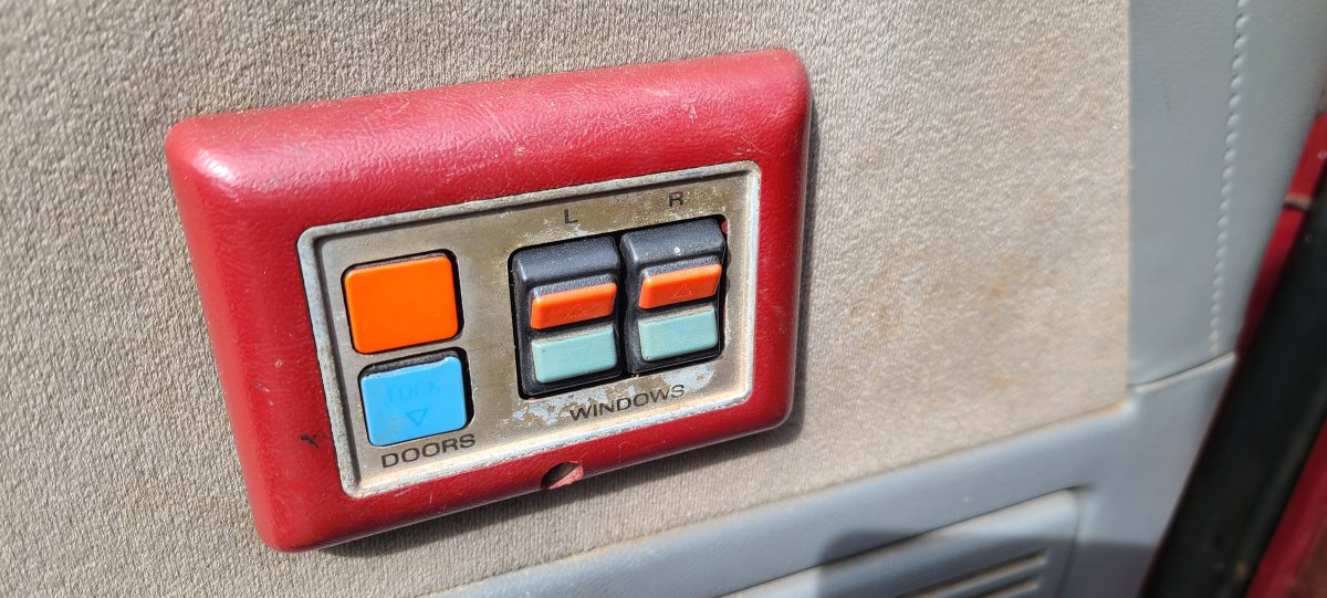

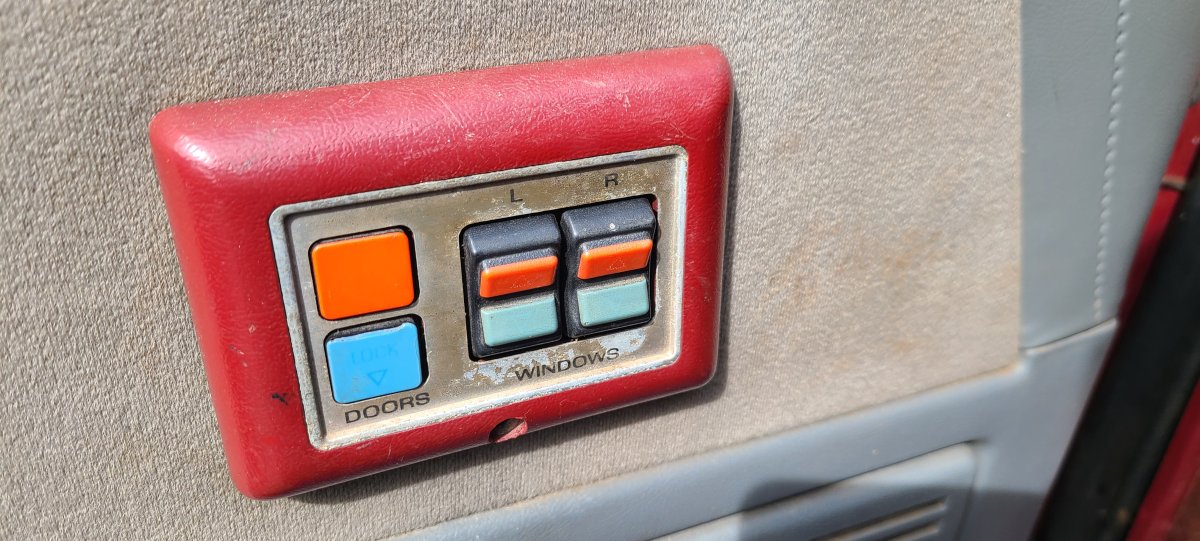

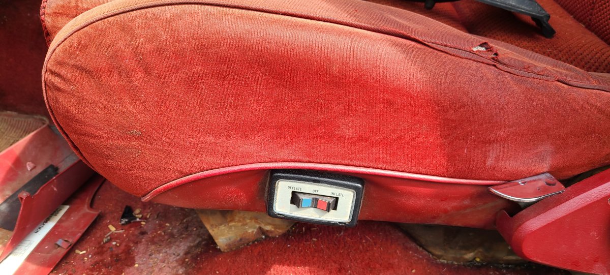

There was a cool '88 Ranger there today. Must have been an XLT. I've never seen these fancy switches for seats and windows.

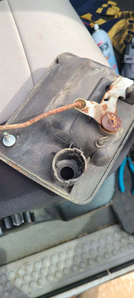

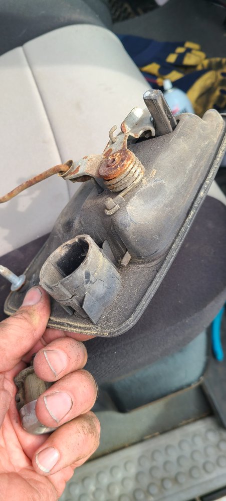

I got the ignition cylinder changed. That was easy. The door locks, however, are a bit problematic. The cylinders I ordered for this year and model of truck are different and don't fit the handle/latch assembly properly. But I already had them re-keyed. So I figured out how to re-engineer them to fit and function. Driver side is finished
Still have to do passenger side. Pictures in a while. On the driver side door, I also tried to troubleshoot the door ajar switch - incomplete. I replaced the doohickey assembly that keeps the door from opening too far. And I applied some lithium grease to the window tracks and now the window cranks all the way down smoothly. Also cleaned and lubed door latch and lock assemblies.

So, here is the difference between the lock cylinders. I may go back to the junk yard tomorrow and harvest some extra latch assemblies for future spares.
New cylinder on bottom
2002 F250 diesel - discovery and build thread.
new on left
I have been getting the itch to convert mine to power windows at least.

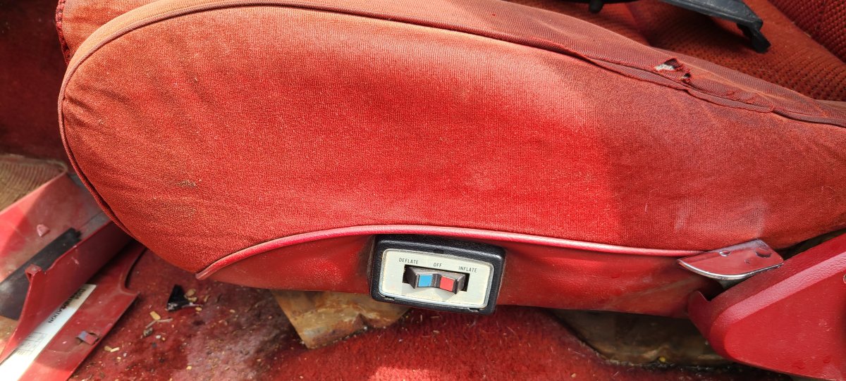

The seat switch is for a little air pump for lumbar support, first and second gens never had actual power seats.
