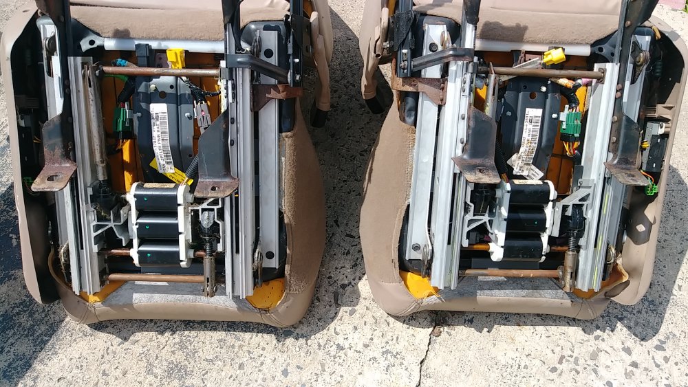

2000 explorer seats fit?
Bottoms..

I think all the wires are local to the seats except a few. Power needs to go to a fused source on the vehicle, and ground of course. Beyond that, you probably have a connector for the seatbelt switch light. I'm not sure on the airbags, but if you don't currently have them I'd assume you could just leave those unwired.

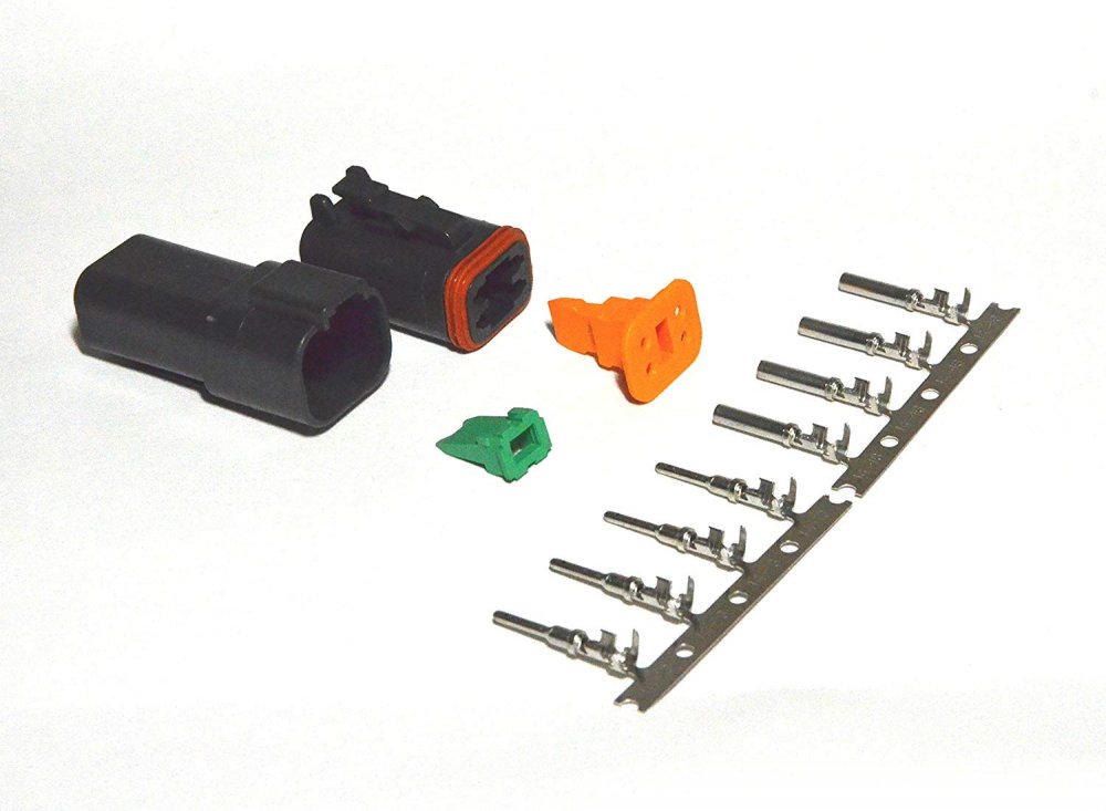

Since you don't have the matching connectors on your truck to go to the seats, you could consider getting a set of connectors that only hold the number of wires you need and wiring those up. As one example, something like these:
https://www.amazon.com/dp/B01IQUXZRA/?tag=959media-20

To the best of my knowledge that's correct. You'll still have two other wires to connect for the seat belt sensor however, which was why I suggested a 4 pin connector. Having the correct ones from the Explorer would be the easier option here.

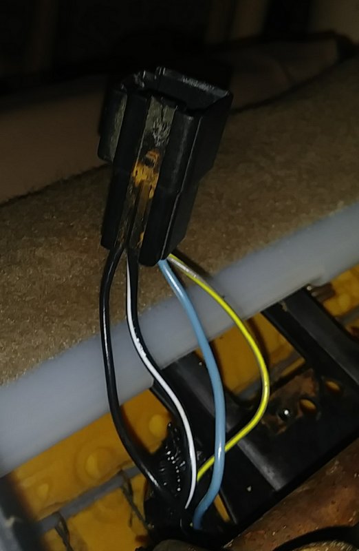

Love this forum! I flipped it over this afternoon just to take a look and took the insulation off the plug still waiting for the plug from the original vehicle. Only 4 wires just like the copy and paste I did in the above I'm going to hook it up to a battery charger some point I'm tired today, but I'm tired everyday!
EditI'm feeling bold after that I went back down the basement , bared (did not cut) the black and the black white. Hooked up the battery charger all the functions work already! Need to do some more checking of the other wires and functions. Move over rocket science you have a new contender!
