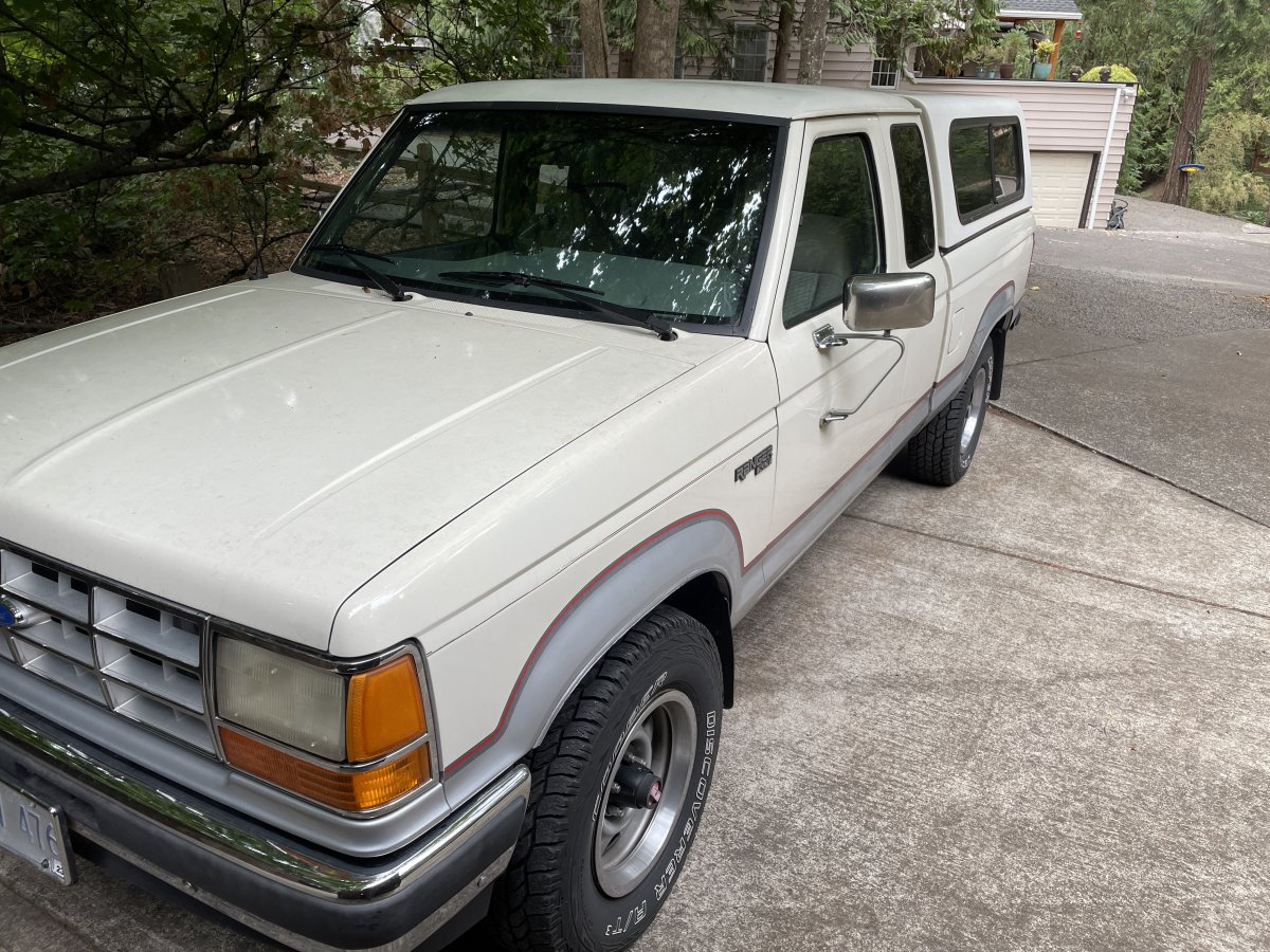

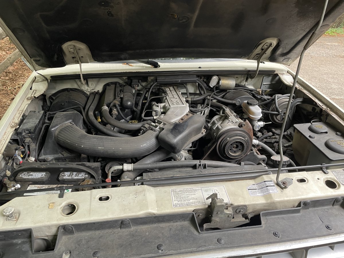

Hey guys so I'm new to all this and have never done anything like to my car before, but I would like to start learning. So i have an 1989 Ford Ranger 2.9L and people have told I should do stuff to it, however people have given so many options I don't know what to do. So I would like it to accelerate faster and also whenever I drive to the beach I'm having to go uphill and in order to just be at the speed limit 55 I have to be pedal to the metal, so I would like to upgrade my truck in a way with that stuff in mind. What would you guys suggest? I would like a really cool but expensive option with also a less expensive but also good options.
Other information since I'm new to this forum. I bought the truck 4 years ago for $4000 with 98k miles on it from an older couple who took very good care of it so it was clean and wasn't a shitbox haha. This was my first car ever so I would like to keep it for as long as possible but still have fun with it. I also don't take it out doing crazy stuff because of it being in such good condition and I would like to keep it until it dies.

A cheap trick is to find a throttle body from an 86-87 2.9......The 89' had a 50 mm TB and the older one is 58 mm.......a significant increase in size. I found a really dirty one, complete, for $20. It won't get you any appreciable HP but the throttle response is much better

Anyways...how steep is this hill? If youre floored to get up it i would first start by making sure the engine itself is healthy (compression check), and making sure the cat is healthy (vacuum gauge), then doing a full tune up and correcting any codes it throws before you go whole hog into a turbo.
Its possible and been done but slapping a turbo on if the thing needs rebuilt is only going to make more issues. Ive never found a hill i couldnt keep 55 up staying off the floor in 5th....unless i was towing something heavy, and then a quick drop to 4th usually solved that pretty quick.
The 2.9 is pretty gutsy given its size and the era it came from. Also curious...you automatic or manual?
But yes swapping to a 4.10 rear would absolultly give you more giddyup, im guessing you have 3.45's now.
I hate to mention this as im the 2.9's biggest advocate but as a last resort if your 2.9 is worn out, or youre still not happy with it after getting it in tip top shape the 4.0 is a pretty easy and common swap, espicially in a 2nd (89-92) gen.
