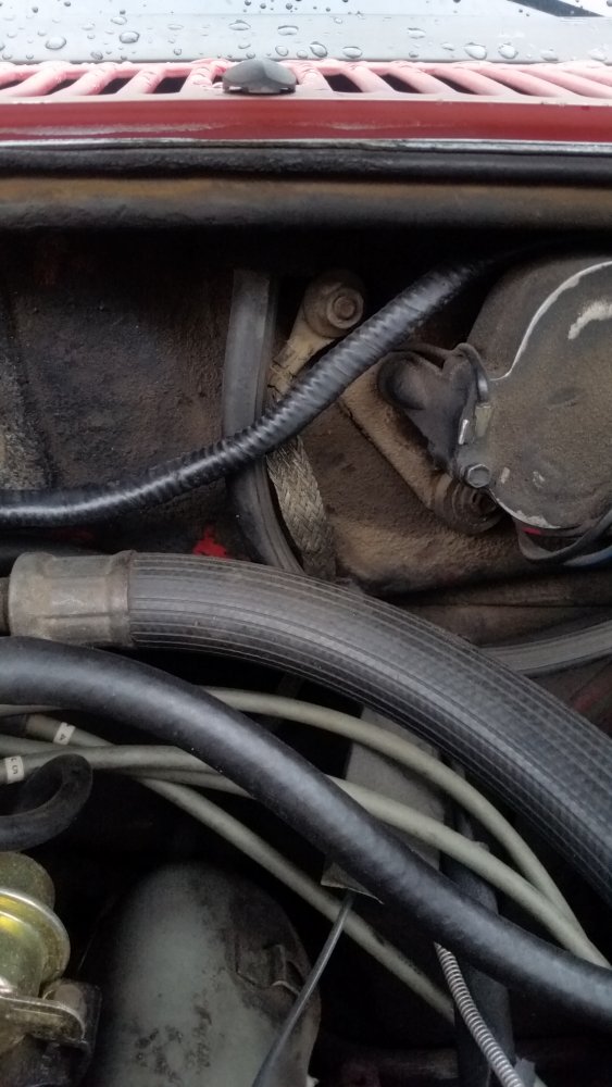

Guys, does the 2.9L use a grounding strap from the back of one of the cylinder heads to the firewall? If so, where on the firewall? Been away from project for years now and forgetting basic stuff
Here's where it goes on my '87. Hmm... it looks like there may actually be red paint under that black/brown firewall :unsure:.
Yes, drivers side head(on the back) to firewall
