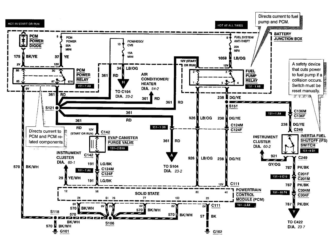

Hello all, I have a 99 2.5 ranger and I was wondering if anyone knew which pins to check on the ecm for grounding and also all of the locations the harness grounds on the truck itself. It is a manual.
Thanks!
I see six different grounding pins in the diagram below

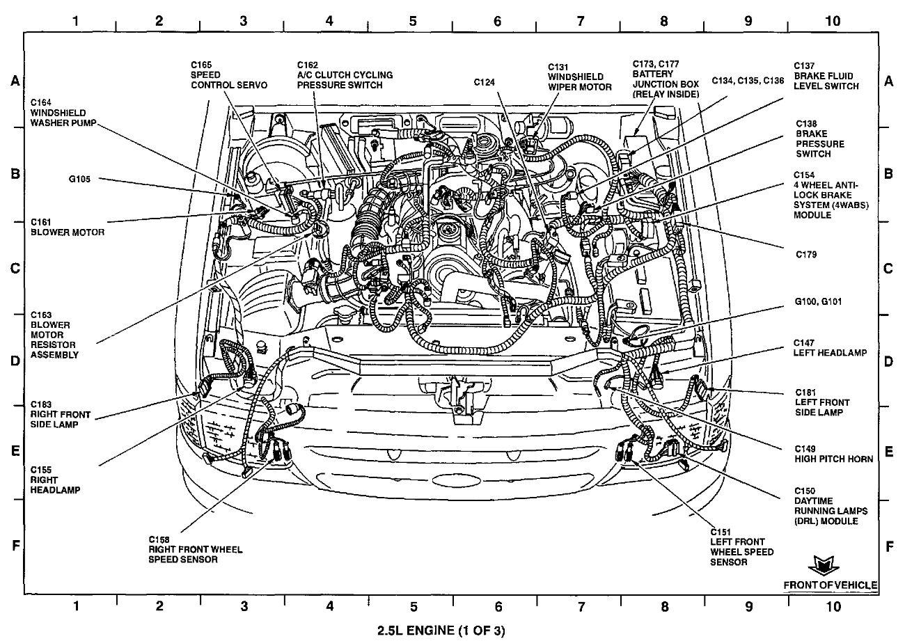

I see those grounds in the above post go to G101 and G102. They are supposed to be in the diagram below. I see G101, I do not see G102. G102 is supposed to be a location A5, right hand side of safety wall.
